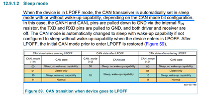

JozefKozon
Dear Abhinand,
Please make sure you have chosen the FS65 type with the CAN interface. Please refer to the Table 1. and Table 2. in the FS6500-FS4500 datasheet attached.
JozefKozon_1-1681819090456.pngJozefKozon_1-1681819090456.pngJozefKozon_2-1681819115043.pngJozefKozon_2-1681819115043.png
Please refer to the section 12.9.1.2 in the FS6500-FS4500 datasheet. If you want to have the CAN transceiver enabled in the normal mode and have the wake up capability through CAN transceiver in the sleep mode, you need to set the CAN mode bits to 11 during the initialization. If the CAN mode bits are set to 11, in the LPOFF mode the CAN mode bits will be automatically set to 10.
With Best Regards,
Jozef
