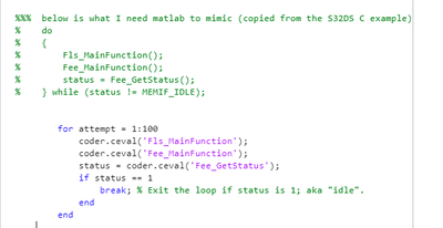

So I have managed to get the custom C code into my model thanks to @BillDuley's answer to the topic. But now I am facing a problem with the NVM read function. In the original Fee_Example_S32K344 provided by NXP, the Fls_MainFunction() and Fee_MainFunction() are called, after which the Fee_Status() is called and only once the status is read as MEMIF_IDLE the Fee_Read() or Fee_Write() calls can be made. Below is the code as in the example project as well is in the custom code (MATLAB function) block in my model
I am debugging my code line by line through S32 Design Studio, and the status variable in my model never goes to 1 (i.e MEMIF_IDLE). What can be the issue and how can I solve it?

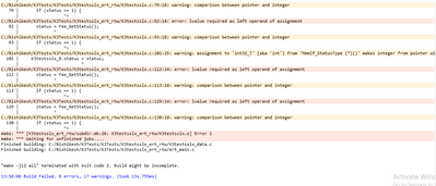

After testing the model for a while, I found the following issues and resolved them to make the model work properly.
1 - The line coder.ceval('MemIf_StatusType status'); when converted to c code (since I was using S32 Design Studio for flashing the model on my board) translates to MemIf_StatusType status(); which caused errors since status() was being compiled as a function call. Removing this line from the MATLAB function block, the errors mentioned in the reply to this answer thread were resolved
2 - Not an issue from the model shared but rather on my end - you need to configure the FLS External Drivers the same way as in the model shared (also in the example code provided by NXP). Since I had not done this in my model, the Fee_GetStatus() never returned an idle state. This is why after following step 1, @BillDuley 's model worked on my board but my own did not.
I used S32 Design Studio version 3.4 for the MCAL configurations. Simulink version R2022a

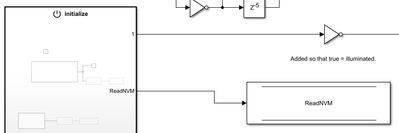

I have the same goal - NVM in Simulink with C function calls. Attached is a zip file of my progress with Simulink calling C code (per the S32DS Fee example):
Perhaps someone can help me see why the values I attempt to write do not present in my Fee read function (I'm trying to read them in FreeMaster). (I did my work in the initialize block to limit my NVM cycles):
FreeMaster:
The Return_Write and Return_Read return a value of zero (happy), but my ReadNVM returns my default value off 0xAAFF, not the expected values per: "DataBlock0 = uint8([0x00, 0x01, 0x02, 0x03]);"
I don't want to hijack the thread, but I think we're on the same path... A little help with my code and we'll all be happy?
