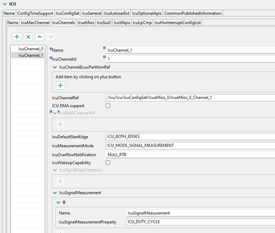

1) Regarding the first method using DIO, you are saying I can use use a pin that is configured as eMIOS and just read it using a DIO read block and use the signal to measure the duty cycle or frequency. Would this measurement be interrupt? I mean, if I set my simulation time step 0.1s, would this method be able to detect PWM signals with frequencies greater than 10? Also, where can I get the GPT block? I was not able to figure out the related library, or the actual name.
2) I tried to set up an ICU channel to capture the input PWM, as shown in the attached image. The ICU channel is set as an ICUeMIOs, however, I am not able to figure out which block in Simulink can output the measured duty cycle. Could you please also comment on this?

Hi, @amir1374,
Regarding the two approaches suggested:
  1. The DIO pin and the eMIOS pin can’t be the same. A hardware connection between these two needs to be done. Given that the DIO block reading frequency is limited by the model step time, as you mentioned, and that estimating the interval between two signal edges is somewhat difficult, I suggest you to use the second proposed method.
  1. For the moment we don’t have an ICU block that handles the ICU API. However, as detailed in the previous post, you can access the RTD API by using Simulink custom code blocks. This is the example previously mentioned that uses the custom code functionality and fits just right for your ICU component:

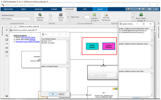

noobsplzwin
Hi Victor,
I'm facing a similar issue to Amir. The ISR custom code example focuses on PWM edge capturing, which is using a Hardware Interrupt Callback for detection. However, duty cycle measurement does not offer callback functions for IRQ-based measurements.
After further investigation, it seems that, besides the Model Header (including the header file) and System Initialization (peripheral init) blocks, we also need to call the continuous Icu_GetDutyCycleValues() function from Icu.h to obtain the data readings.
I tried using a C/C++ block in Simulink to call them, but it couldn't locate Icu.h and couldn't recognize the Icu_ChannelType during compilation. Could you please advise me on the correct method to call the API function from the RTD driver in Simulink?

georgevictor
Hi @noobsplzwin,
You can search the definition of those data types inside RTD and see their base type (uint8, unit16, etc.). In Simulink, use data stores with the same base type as the ones from RTD. In the case of custom data types like enums or structures (Icu_DutyCycleType), you can create user defined data types inside a Simulink data dictionary (an sldd is automatically assigned to a model set on the S32K3xx platform) like: Simulink Enumarated Type or Simulink Bus. Add data store memory blocks to use the previously created data types.  A data store should be declared as volatile, otherwise, Simulink will declare the variable inside a structure starting with the model's name.
The Icu_ChannelType is an uint16 at base. The Icu_DutyCycleType data type can be replicated with a bus structure composed of two uint32 elements. Icu_DutyCycleType -> struct(with two Icu_ValueType elements) -> Icu_ValueType -> Icu_TimerRegisterWidthType -> uint32.
The Icu_GetDutyCycleValues function can be used inside Simulink in multiple ways. Some examples are: a System Outputs block where you can write C code line by line, a C/C++ block like you mentioned or a MATLAB function block together with coder.ceval.
You may need to include the headers or source files where the data type that you want to use is declared.
