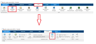

In the screenshot, I see that you run the example in SIL/PIL mode. I strongly recommend to use 'Embedded Coder' to build and deploy the application on the board as time sensitive tasks (like communication) can have undefined behavior in SIL/PIL mode as it doesn't run in real time.
Secondly, make sure you have a slave connected to the master otherwise LPI2C communication doesn't work.
