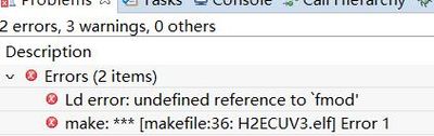

Hi Dear Colleagues,
My customer met a problem when using S32DS to compile and debug project generated by MBDT:
Sometimes it's "undefined reference to 'floor'", do you know what is missing? Thanks

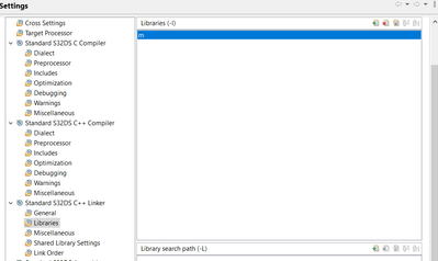

vladmitroi
Hi @WeoWang ,
Please make sure you have the math library (-lm) linked to your S32DS project.
Vlad M.
