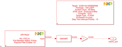

My Simulink diagram is as follows:
in fact, you can see how Simulink suggests that at the GPI Read block output, there is a boolean.

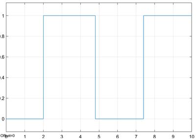

I can graph it via scope bl during the simulationock, but I can only see 0 or 1.
any suggestions for reading the entire set of values associated with the potentiometer?

Hello @pierpaolo_dini ,
The GPIO blocks are digital so they can only read/write logic values (0 and 1). If you want to use the potentiometer, you have to use the ADC (Analog To Digital Converter) blocks. You can check adc examples to see how to use them.
