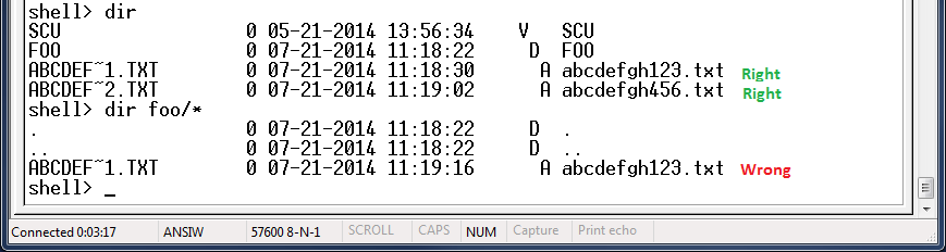

The problem comes when you call ioctl(IO_IOCTL_GET_LFN) and pass it an MFS_GET_LFN_STRUCT that has been created for you by calling ioctl(IO_IOCTL_FIND_NEXT_FILE). This is a fairly obvious workflow and is used for example in _io_mfs_dir_read(). The problem is twofold:
  1. ioctl(IO_IOCTL_FIND_NEXT_FILE) fills in the PATHNAME field not with the path but with just the filename. The path is omitted.
  2. ioctl(IO_IOCTL_GET_LFN) does a brain-dead search for the short filename starting at the root of the filesystem. Since short filenames are not unique across the whole filesystem (only in a given directory) it may or may not find the right file. What you get back may be the long name for the file you wanted, or for a completely different file in a different directory that happens to have the same short name.
You can easily see this issue, for example on a K60 tower using the shell "dir" command in the stock example application. Create files on an SD card with the following directory structure using a PC, put the card in the tower, then use the shell dir command. Look carefully at the long filename for the file in the subdirectory; it's wrong.
This is not the fault of the Shell_dir() command. It is caused by the underlying _io_mfs_dir_read() as described above.

RadekS
Hi Rui,
MFS was reworked in MQX 4.2.0. So, MQX version 4.1.1 still contains this bug.
Unfortunately I am afraid that there isn’t any specific patch for MQX version 4.1.1.
I would like to recommend use latest version MQX 4.2.0 and apply also patch MQX 4.2.0.1 Software Patch for fix some of issues in MQX 4.2.0. Optionally you could try importing just new MFS into your MQX 4.1.1.
