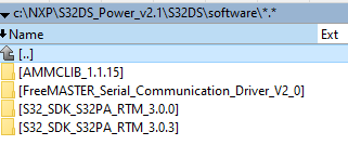

     How to download and install MPC5575B SDK?
     I can't find MPC5575B SDK after I install the S32 design studio for Power architecture.
     I get an error when I open a project, seems missing MPC5575B SDK.

SDK is installed into c:\NXP\S32DS_Power_v2.1\S32DS\software\ folder. You can check if you have it there
It is installed online via S32DS Extensions and Updates, but also offline option is available
https://community.nxp.com/t5/S32-Design-Studio-Knowledge-Base/HOWTO-Update-S32-Design-Studio/ta-p/11...
BR, Petr

sorry, I spell error.
It should be MPC5775B SDK    not MPC5575B SDK.

Hi Petr,
Thanks very much!
