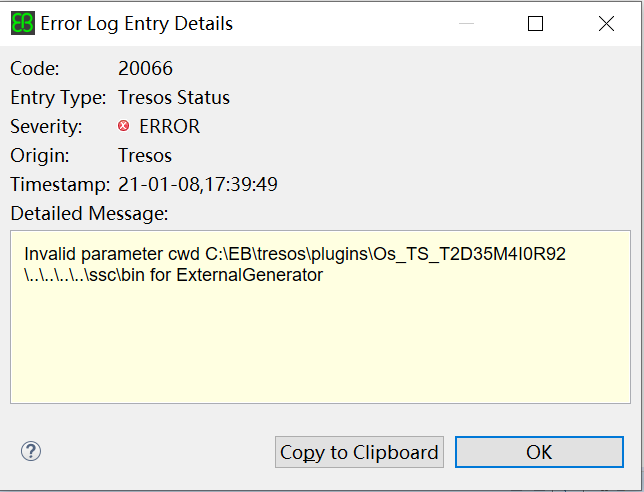

I have installed Tresos Studio 24.0 and loaded the official demo
JRE 6 and JRE 8 are not installed at the same time
Also errors like https://community.nxp.com/t5/S12-MagniV-Microcontrollers/I-have-a-problem-with-S12Z-AUTOSAR-OS-4-0-8...

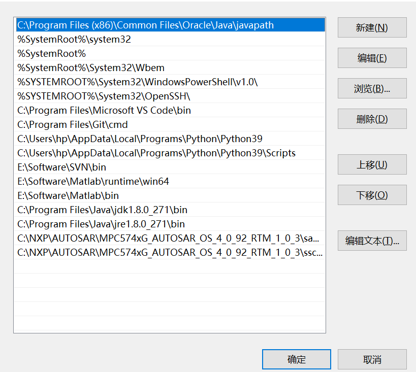

Hello lubo_NEW,
Please check your java version, by opening Command Prompt, then type: java -version. There are some cases which the java installers are duplicated by multi version, and perhaps the current java version is incorrect. In my computer, the java version is:
java version "1.8.0_221"
Java(TM) SE Runtime Environment (build 1.8.0_221-b11)
Java HotSpot(TM) 64-Bit Server VM (build 25.221-b11, mixed mode)
And I can successfully run with that version.
If you have already installed the correct version and still faced the issue, then please open the Command Prompt, change direction to the
"[your OS folder]\MPC574xG_AUTOSAR_OS_4_0_92_RTM_1_0_3\sample\standard\sc1\src"
Then call the below command and check if it can generate configuration file successfully:
[your OS folder]\MPC574xG_AUTOSAR_OS_4_0_92_RTM_1_0_3\ssc\bin\generator\sg.exe sample1_5748G.epc

Thank you for your reply, but I did not succeed. Could you please help me check what the problem is

Here are the installation tips

I have the same problem, and I used your guidance. But no change in errors state. Could you please help me, how can I get rid of this problem?
please find the attachments for more help.
