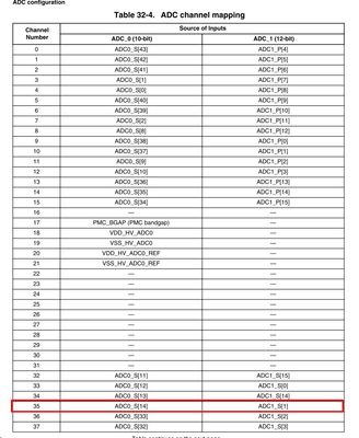

Thus, I want to ask about the possibility to include the analog signal in PG13 and convert the signal using ADC1
And if possible, how should I know the corresponding channel number since I want to enable the channel but I can't find the information about the channel number.

Simply connect your analog signal to pin header J14 pin 1.
Next you need to check internal routing of ADCs: In this case it is channel35
 as you can see from routing table:

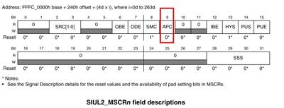

Last thing you need to se it APC bit in SUIL unit for corresponding MCSR register. Which is in this case MCSR 109.
After setting this you are ready for measurement of PG[13] channel via ADC1 channel 35.
