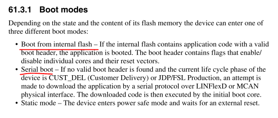

3,058 Views
lukaszadrapa
just notice that serial boot is invoked only if no valid boot header is found in flash. Once the application is programmed (and valid boot header is present in flash), it is not possible to run the serial boot again. The boot header would have to be invalidated by application.

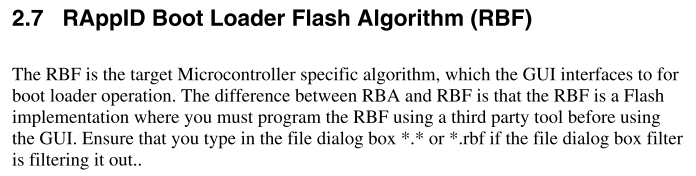

lukaszadrapa
Rappid BL for MPC57xx devices support only "RBF" - that means flash version. First, you have to load flash resident Rappid bootloader to flash using JTAG tool and then you can use Rappid interface to load an application. The reason for this solution is mentioned in my previous post - if valid boot header is present, BAF (serial boot) is not started.
This is different from MPC56xx devices - Rappid bootloader for MPC56xx can be used directly. BAM serial boot is used, so you don't need to use JTAG to load flash resident bootloader. The boot mode is controlled by pins, so the limitation mentioned above is not present on MPC56xx.
So, the answer to your question is no.

3,060 Views
lukaszadrapa
Hi Jordi,
that's possible but you have to develop own bootloader.
You can read in user manual for Rappid bootloader that MPC56xx devices support RBA algorithm and MPC57xx RBF algorithm. In case of RBF, it is necessary to load the bootloader to flash using JTAG tool:
You can read this thread:
https://community.nxp.com/thread/320166#386416
It describes how to create a RAM image which can be loaded to RAM by BAF/BAM.
Lukas

dmitriynechkin
Serial bootloader allow to load user program into internal SRAM, using LINFlexD or MCAN serial interface, then to execute that program. That program can then be used to control the download of data and erasing/programming of the internal or external flash memory. Protocol is the same as on older devices: Transfer valid PASSWORD -> transfer Start_ADR and SIZE -> transfer your code -> run code and do anything you want.
You can use any hardware you like, what supports LIN or CAN transfer. As i konw, the is no universal software to read/program through BOOT, but i know several companys who develop this sotware.
