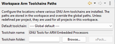

Arm Toolchains Paths:
Global Toolchain settings:
Workspace toolchain settings:

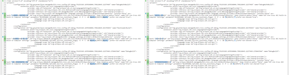

I talked about this problem with one of my colleagues and he figured that the issue could come from the language settings file. The project triggers no error on his PC so he sent me a copy of his language settings. Here is a comparison of my file and his file (his file is on the left, mine is on the right):
Do you think this difference could be the reason why this error happens?
This colleague also mentioned that he used one of your articles to setup the project when the company was starting and the project was created. Thank you for your help!

Yes, that difference could cause the messages. You could try to replace the &quot with "
Another approach would be to delete the .settings and re-open the project: the files should be restored (that's why I do not store the .settings folder in a VCS, but there has been some debate about this in the past in other places).

Replacing the changes in the language settings and deleting completely the .settings folder was unsuccessful, but I clicked on "Restore Defaults" in the language settings provider options of the CDT Arm Cross GCC Built-In Compiler settings and the errors have disappeared, even though the command to get compiler specs and the other options remain the same.
