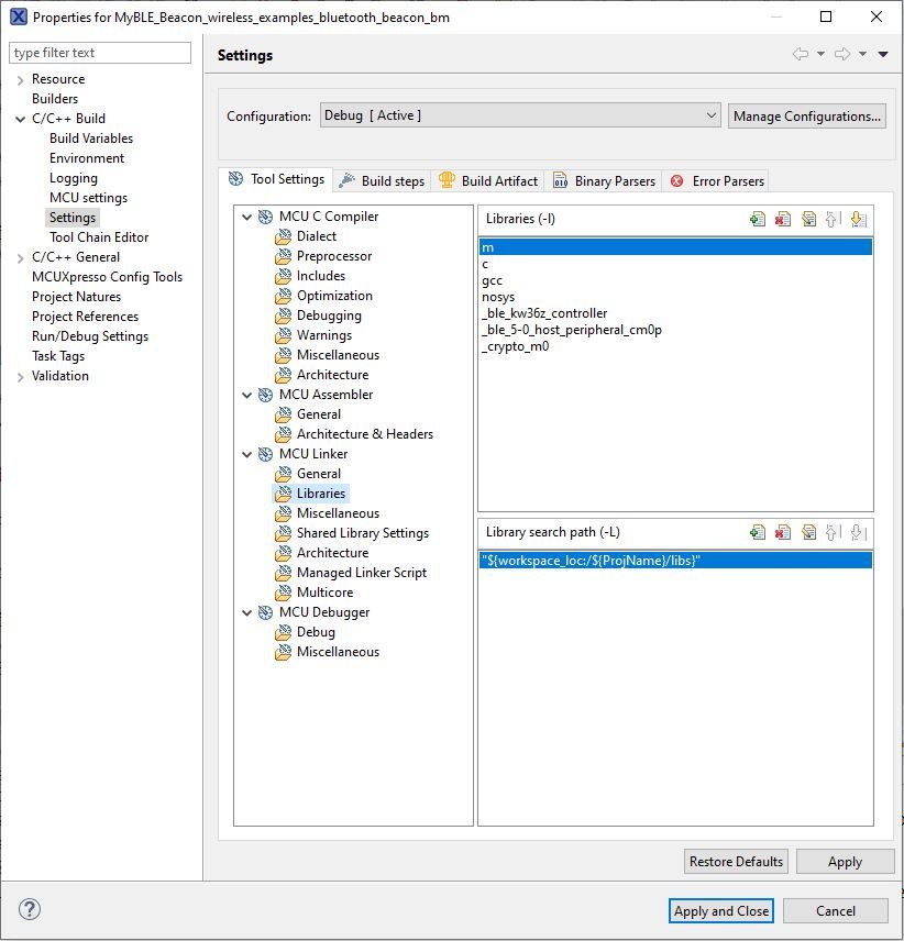

Could you please take a look at section 9.8 of the Bluetooth Low Energy Application Developer's Guide to see if you successfully configured the use of the alternative libraries instead of the combined Central and Peripheral Host Stack library?

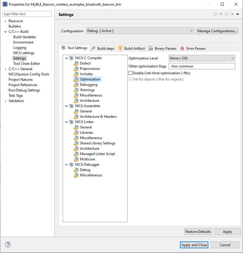

Yes, I go through the Section 9.8 of Bluetooth Low Energy Application Developer's Guide and found only Peripheral Host library is used in our application. After this I build the project again and it showing the same as size as 510 KB.
Then, I changed the Optimization level of the application source file (beacon.c and beacon.h). But no change in the size of output file.
For your information, I am using MCUXpresso IDE and Creating the SDK example of Beacon project by click on Import SDK example. I am also attaching the images which shows the included library files and Optimization level while Debug or Release.
                                                            Library Settings
                                                   Optimization Level While Debug
OptimizationWhileRelease.JPG                                                   Optimization Level While Release

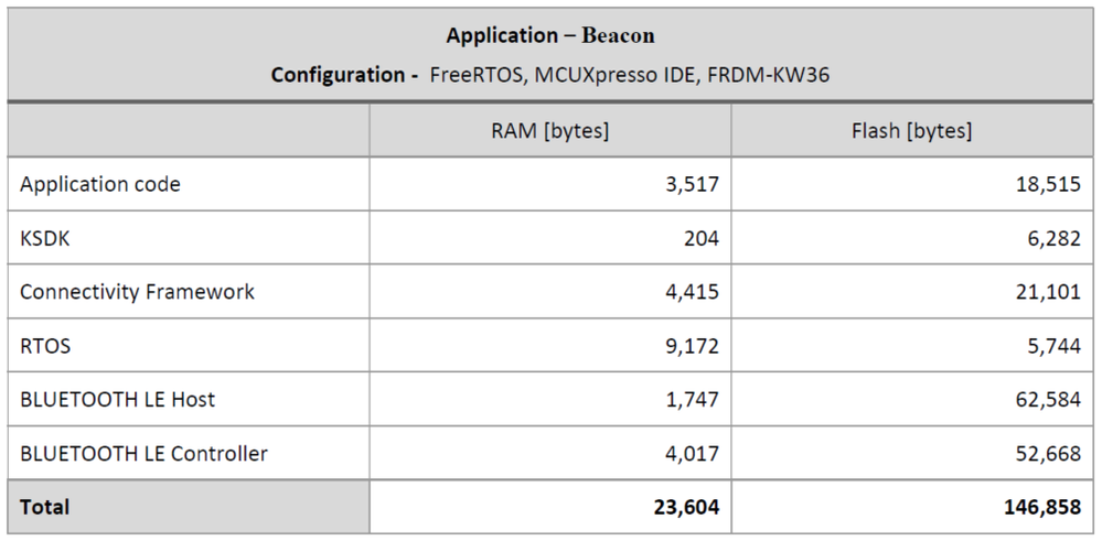

The Bluetooth Low Energy Release Notes document included with the KW36Z's SDK has memory footprint information for all of the included examples. For reference, here is the footprint information for the BLE Beacon example:
The path for the document is:
<…\SDK_2.2.1_FRDM-KW36\docs\wireless\Bluetooth\Bluetooth Low Energy Release Notes.pdf>
Could you please take a look at this application note showing how to add CAN or LIN functionality to a Bluetooth Low Energy example? It uses the Wireless UART example, which has the largest memory footprint of any of the BLE examples.

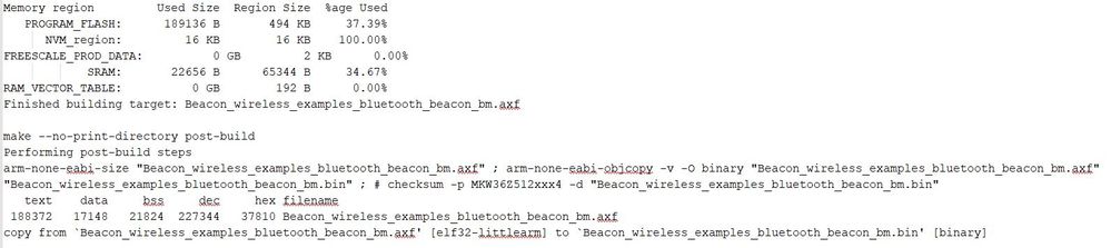

We checked the Build log in IDE and found below changes:
For Original Example Code:
For Modified Example Code:
Kindly also suggest how much Flash size will be used by code?

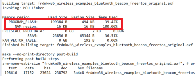

Please consider the size that MCUXpresso reports after building your project as the actual space in flash that will be used by your program.
For example:
Here, 199.384 kB are being used, out of the available 494kB of the available PROGRAM_FLASH memory region. This results in a usage of only 39.42% of the available program flash.
The Release Notes document only shows the memory footprint of FreeRTOS example projects.
Please let me know if you have any further questions.
