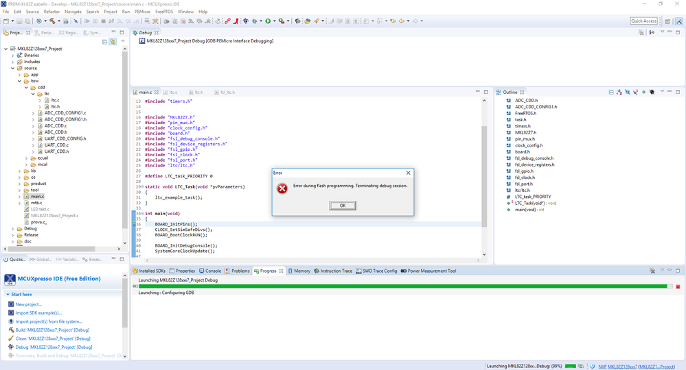

- Every time I try to debug or flash the program, the yellow LED turns OFF, the red one turns ON and this is what I get from the IDE:

- I tried to reflash the bootloader copying the "k20dx128_bootloader_0x5000.bin" and the "k20dx128_frdm_kl82z_if_0x5000.bin" files into the virtual bootloader drive that pops up in my computer (one at a time, not both files at the same time). The yellow LED then keeps blinking rapidly but I don't know what it means. According to this file (Section 3, page 8), 2 seconds off + 8 rapid ON/OFF blinks means an error, but I don't get the 2 seconds off, just constant rapid blinking. After a few minutes I unplugged the board and plugged it again to enter normal mode, but the result is exactly the same.

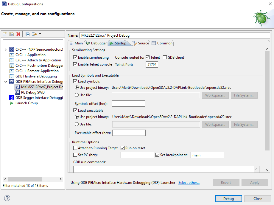

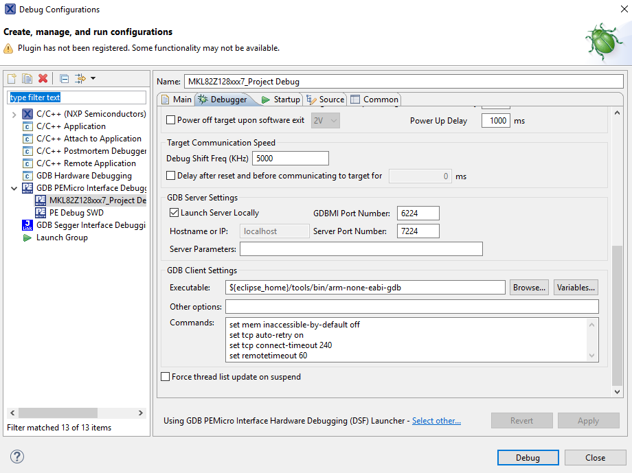

I've tried to tweak here and there the P&E debug configuration, but with no result, so here I show it cause maybe there's something wrong I'm unable to see.
I'm connecting the P&E to the SDA/JTAG connectors. That's how it has to be done, right?

BlackNight
You need to specify the correct MCU.
I have described now all the steps in the following article:
Recovering and Updating the NXP OpenSDA Bootloader with P&E Multilink and MCUXpresso IDE | MCU on Ec...
