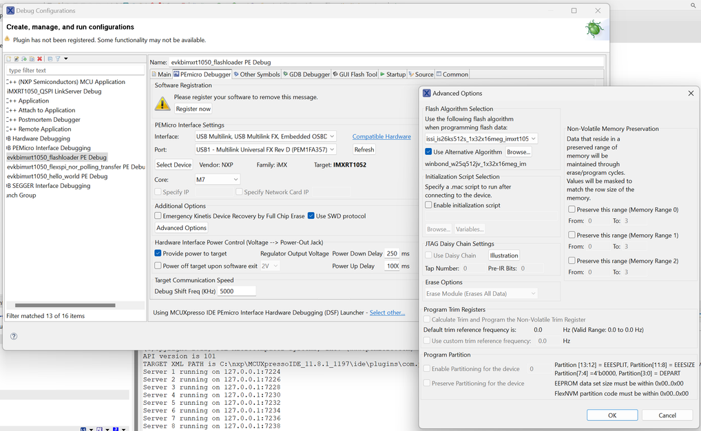

Hi! I am working with a custom board developed from the standard MIMXRT1050-EVKB with a RT1052 and a Windbond W25Q512JV. I tried flashing the SDK example flashloader onto my flash with two custom pin configurations that should boot up the LCD monitor on my board, using the GUI Flash tool. While the tool runs successfully without error, it seems that the tool didnt actually flash any image into the flash. The console log is as below:
P&E GDB Server for Arm(R) devices, Version 9.33.00.00
Copyright 2018, P&E Microcomputer Systems Inc, All rights reserved
Loading library C:\nxp\MCUXpressoIDE_11.8.1_1197\ide\plugins\com.pemicro.debug.gdbjtag.pne_5.7.3.202310061729\win32\gdi\unit_ngs_arm_internal.dll ... Done.
Command line arguments: -interface=USBMULTILINK -port=USB1 -speed=5000 -flashobjectfile=C:\Users\<user>\Documents\MCUXpressoIDE_11.8.1_1197\workspace\evkbimxrt1050_flashloader\Debug\evkbimxrt1050_flashloader.axf -device=NXP_iMX_IMXRT1052 -programmingtype=0 -runafterprogramming -startserver -singlesession -quitafterprogramming
Device selected is NXP_iMX_IMXRT1052
User Specified Hardware Selection : Interface=USBMULTILINK and Port=USB1
Connecting to target.
Unable to load libusb0.dll
PEmicro Interface detected - Flash Version 11.22
Device is NXP_iMX_IMXRT1052.
Mode is In-Circuit Debug.
(C)opyright 2012, P&E Microcomputer Systems, Inc. (www.pemicro.com)
API version is 101
TARGET XML PATH is C:\nxp\MCUXpressoIDE_11.8.1_1197\ide\plugins\com.pemicro.debug.gdbjtag.pne_5.7.3.202310061729\supportFiles_ARM\target_v7m_vfp.xml
Server 1 running on 127.0.0.1:7224
Server 2 running on 127.0.0.1:7226
Server 3 running on 127.0.0.1:7228
Server 4 running on 127.0.0.1:7230
Server 5 running on 127.0.0.1:7232
Server 6 running on 127.0.0.1:7234
Server 7 running on 127.0.0.1:7236
Server 8 running on 127.0.0.1:7238
Server 9 running on 127.0.0.1:7240
Server 10 running on 127.0.0.1:7242
All Servers Running
Target Disconnected.
It seems like the tool just terminated without doing anything.
I customised two GPIO pins to output on the LCD. It can be switched on without any error during debugging,
with the rest of the build identical to the SDK example.
I have built a custom .cfx with the correct flash device configurations and QE_bit_config.
I am also using an .arp for the flash that is unavailable in the IDE.
Debugging SDK example flexspi_nor_polling_transfer is also successful.
I understand that using MCUBootUtility is a more simple way to flash but both USB-HID and UART are unavailable options for my board.
I only have the option of JTAG through a P&E USB UNIVERSAL FX.
I tried both flashing when the board was boot as serial downloader and internal boot,
and tried to boot the board in internal boot mode to see if the LCD is switched on.
Is there any flash specific configurations that I still need to alter to make this tool work?
Is there any alternative way for flashing?
Thank you.

Additional Info:
I noticed that the Flash tool used
instead of my provided .arp to flash the image. Although I have already configured the debug configuration to use my dedicated .arp.
The dedicated .arp file will be used to erase the flash memory if I use the GUI Flash tool's 'Erase' function,
but it won't use it to flash, which is confusing.
