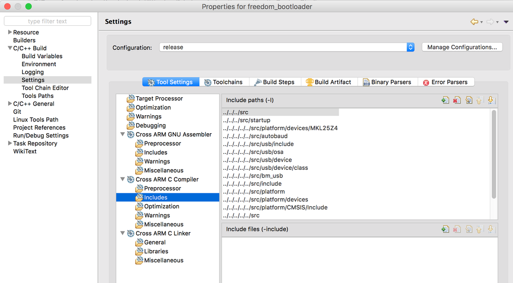

As per this post on building a custom bootloader, I can compile and run the Debug target for my code.  However, switching to a Release target generates many (many) errors.  Here are some examples of the errors:

It appears that the include path is not set up properly.  Is there an obvious place to check on this?

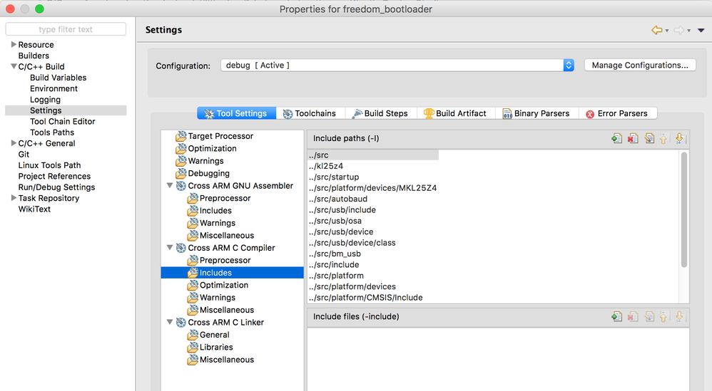

Solved.   I think.
When I set up the project, as per guidance from Erich Styger, I adjusted the Include Paths for the Debug configuration, but not for the Release configuration.  See images below:
Should be an easy fix...
NOTE: You may also need to update Cross ARM C Linker => General => Script Files (-T) to match the debug config as well.
