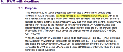

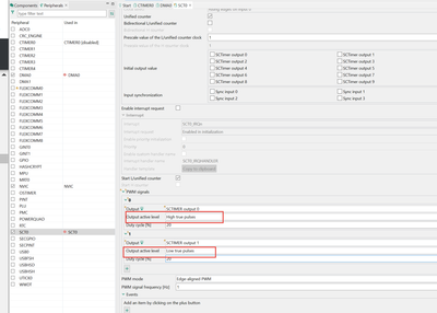

Hello @skanda19
You can refer to AN11538, or use MCUXpresso config tool:
Alice
