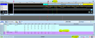

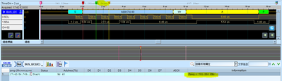

Hi Community,
I need 1Mbits/s I2c communication, but it just reach 800kbits/s
The attachment lpcxpresso55s28_i2c_interrupt_b2b_transfer_master.7z is SDK example code that use FC4 (PIO1_20 and PIO1_21).
In addition, I refer to How to Configure LPC55S16 I2C to Fast Mode Plus
It seems to be a different problem, because it already enable the FRG4 in example code.
The attachment LPC55S28_test.7z is my own code that use FC1 (PIO0_13 and PIO0_14) based on MCUXpresso config tool.
I follow the document UM11126 (Table 336.)  to set pins with config tool, but the result is still 800k.

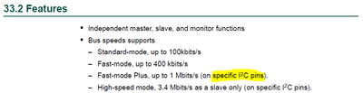

By the way. Refer to the document UM11126 CH.33.
Are FC0 to FC7 able to reach 1M, or just FC1 (PIO0_13 and PIO0_14) can be configured to 1M?
It doesn't mention about which are the specific I2C pins for FM+.
Let us double check this information, since as you mentioned it is not very clear which specific I2C pins should be used for Fast-mode Plus or High-speed mode. We will let you know any information regarding your case as soon as possible.
