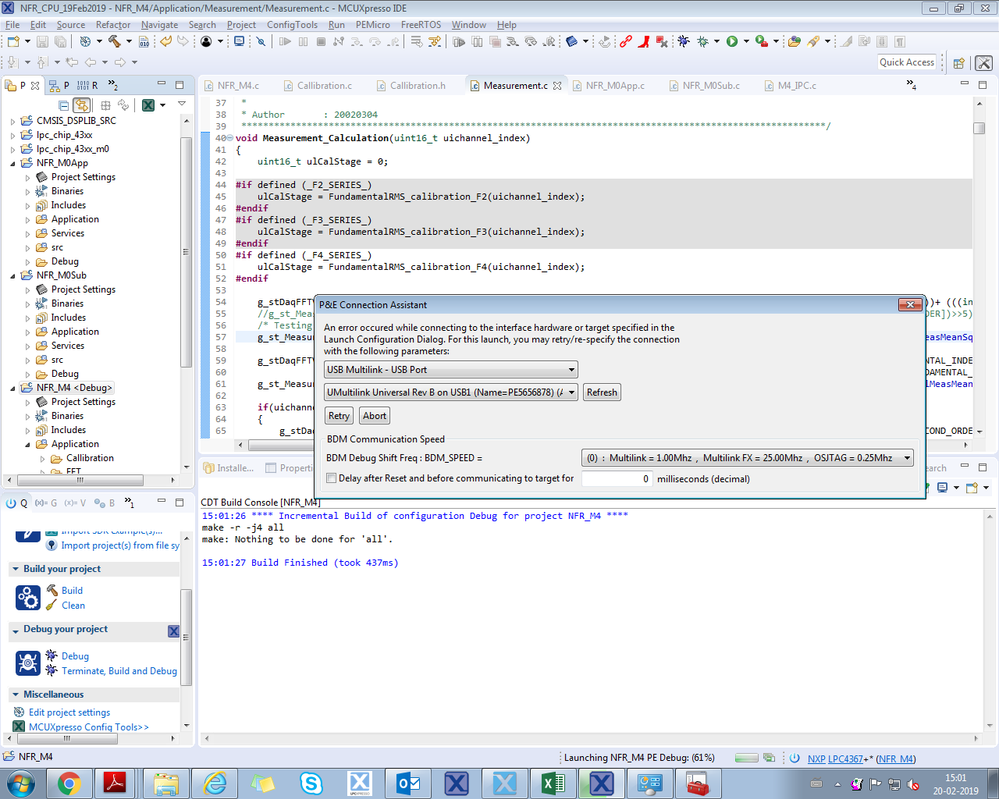

I am using P&E Micro Multilink Universal for debugging my development board. I am using LPC4367. It was ok till the time i was using LPC link3 which is there in the evaluation board OM13088.
Since our new development board has come and alreasy we have multilink universal used in our other projects, i want to use thesame for debugging this development board.
Following is the error which I am facing.
unable to proceed further please suggest the solution for the same.

Is this a brand-new board design, that you have never debugged before? If so, I suggest you read:
https://community.nxp.com/thread/388998

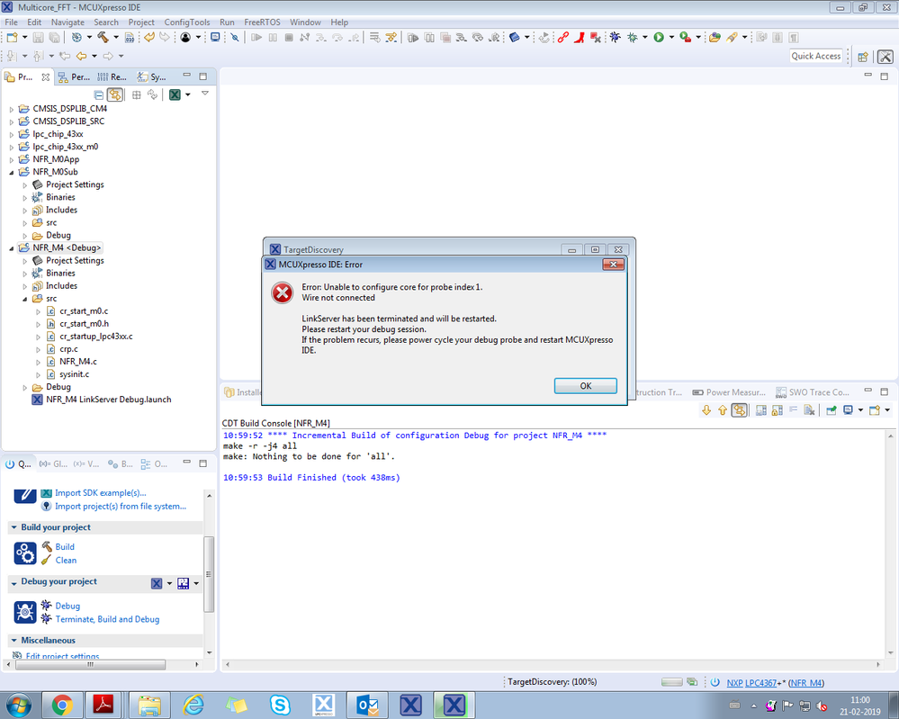

As per the link i refered and check. It is proper . I also refer  Using the LPCXpresso V2/V3 Boards to Debug an external Board | MCU on Eclipse  which says that using the eval boad youcan program the external controller as well. So I am trying to connect OM13088 Eval boards LPC link2 to ny Eval board  using the below mentioned connector and jumper modifications.
But it gives following error msg.
Trying to debug byt need your suggesstion for the same.
Gaurav More

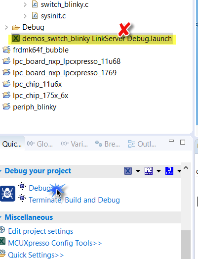

Hello Gaurav More,
- The debugger on LPCXpresso V2/V3 board or LPC link-2 doesn't support P&E probe. It only support Liner server and J-link.
-Before debug, please delete the Debug file under Debug folder, or the debugger will use the old one.
then click debug button:
- When short JP1, it means your target board do not need external power.
- Also as Con Verse mentioned, how about link-2 ?

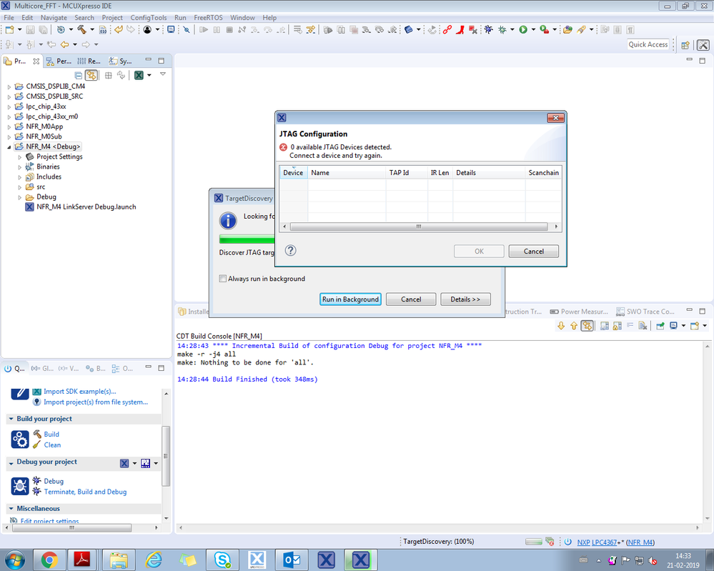

gauravmore
Hi Alice,
I followed the same procedure but still it is giving the same error msg as mentioned above.
0 avialable Jtag Detected.
Now i am trying to debug LPC11u68 board with the same board.to check whether there is a problem with the developement board,
Please suggest till i check the other ways around.

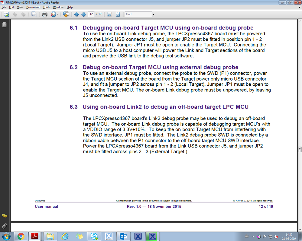

I tried to debug from one MO13088 to  another OM13088 and i am able to programm and debug as per the guiddelines provided  in User manual
UM10946
LPCXpresso4367/43S67/18S37 Rev B Boards
Rev. 1.0 — 18 November 2015 User manual
But still not success in debugging my Board. The difference between my board and the the eval board is mine is  LPC4367JBD208
But still what is missing has anyboy tried with there development board. if so then plese share the board files for the mentioned part number and method of debugging the same.

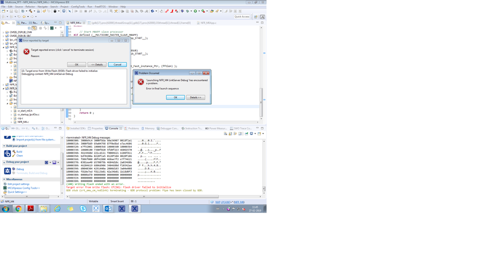

  Initially it was programming when it was powered through JTag, but then when I put the RC circuit on REset as per the schematic of OM13088 it stopped debugging Even after powered Through JTag,
While debugging I am getting Follwing Error and the debugging stops while launching

(100) Writing Flash ended with an error.
Target error from Write Flash: Ef(50): Flash driver failed to initialize
GDB stub (crt_emu_cm_redlink) terminating - GDB protocol problem: Pipe has been closed by GDB.
What would be the reson as I am also refering the forum
https://community.nxp.com/thread/491549
But still no success, Please let me know what is missing.

code (at 0x10000000) not set as written - corrupted at 0x10000000 (word 0)
Driver from AXF file:
10000000: 23010020 54000045 00001032 10000000     ..#E..T2.......
Driver code in memory:
10000000: 018785f2 54000045 00001032 10000000    ....E..T2.......
I have highlighted the words which are not matching but the same code is getting programmed in other board. I tried multiple times. I did this with LPC xpresso.
I referred the forums as mentioned earlier  MCUXpresso IDE v10.3.0 [Build 2200] Problem [BUG?].  In that they have mentioned how to get the debug access. But  It is not working for me.
Is there any provision to erase the flash before writing in LPC Xpresso?

the debug circuit on LPCXpresso V2/V3 boards only supports debug of SWD systems, not JTAG. On the LPC43xx/LPC18xx devices you can only do multi-core debug using JTAG (since SWD didnt support multicore at the time these devices were designed).
You can still debug the main core of the LPC4367 using this type of setup. You would need to buy a P&E, SEGGER or LPC-Link2 probe to get access to the M0 cores in your device, provided your circuit is designed for SWD. Looking at your JTAG connector, it is not laid out as a standard ARM SWD connector.
I would suggest checking that the LPC11U68 board you have can connect to the OM13088 as a first step, using an SWD connection.

Yes  I am trying to debug mt development board using LPCexpresso evaluation board OM13088. I made the connection and tried to program. I refered this line mentioned in
UM10946 /  LPCXpresso4367/43S67/18S37 Rev B Boards/  Rev. 1.0 — 18 November 2015 User manual , Point 6.3
mentioned below.
And initiiating the debugging i got msg.
It seems that I am not able to get the JTag Device detected. Any suggestion for the same.
