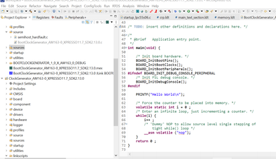

Hello @MarcoGiammarini
I received your projects. Which IDE do you used?
After import it into MCUXprsso IDE, it seems not works well. Not shows the code you mentioned above.
Just as below:
Also linker file not right.
Alice
