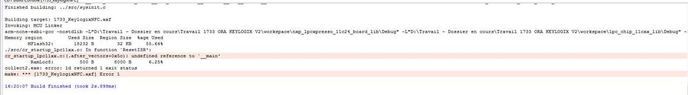

I'm using an LPC11C24 and I implement in my code the printf routine, using redlib.
But the printf function is very heavy in term of code size. So I tried to use the redlib nano, but I still have the following compliation error:
Any idea to fix this issue ?

I have used both redlib and newlib(nano) in some projects.
While I prefer newlib (redlib is closed source and development seems to have stopped) I have also noted that newlib(nano) grabs about 1.5k of RAM right at the beginning.
For the LPC11xx series that is quite a lot.
In terms of ROM footprint redlib and nano were on equal footing (2015).
Mike
1,689 Views
converse
Senior Contributor V
If you look in the startup file, you will see that this code is conditionally compiled if you have __REDLIB__ defined. So, stop defining __REDLIB__.
Alternatively, read this FAQ on switching between the different C libraries:
https://community.nxp.com/thread/389104
