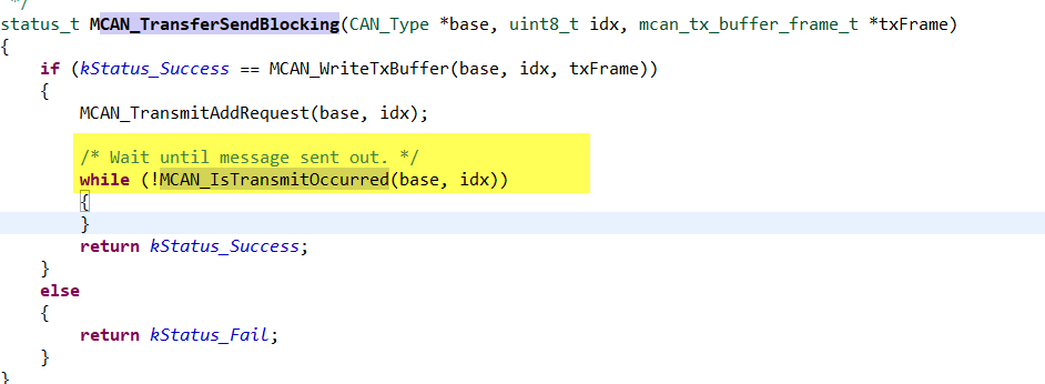

There appears to be an issue with the CAN_TransferSendBlocking function. Occasionally the function does not return, waiting for the appropriate bit to be set in the CAN TXBRP register (Tx buffer request pending register), see below.
status_t CAN_TransferSendBlocking(CAN_Type *base, uint8_t mbIdx, can_frame_t *txFrame)
    /* write the message to the message buffer */
    status_t status = CAN_WriteTxMb(base, mbIdx, txFrame);
    if (status == kStatus_Success)
        /* wait for completion */
        while (!(base->TXBRP & (1UL << mbIdx)));
    return status;
Should this blocking loop be looking at the TXBTO (Tx buffer transmission occurred register) instead, e.g
        while (!(base->TXBTO & (1UL << mbIdx)));
We have used this CAN driver in a couple of projects without any issue, where we are using only one of the CAN modules. The project where the function does not operate uses both available CAN modules, but I don't see why this should be having any effect.
Does anyone have any information/ideas?

Hello Shaun Oldale,
yes, you can have a look at the MCAN driver under SDK:
