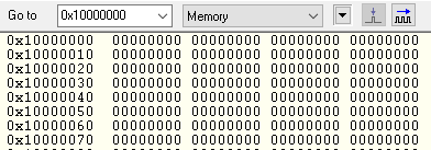

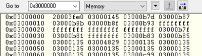

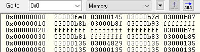

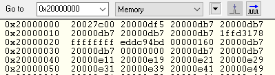

4. After SPIFI_INIT (), the memory show as below:
springc_2-1646648196067.pngspringc_3-1646648208862.pngspringc_4-1646648221089.pngspringc_5-1646648232661.pngspringc_6-1646648245886.png
It means already copy 0x3000000 rom code 512 byte to 0x0 sramx region. my bootloader image also download to sram0 0x20000000. but, flash 0x10000000 shows all 0s. 0x40080014 always un-readable. Erase/ Write flash do nothing. What is the trouble on this?
