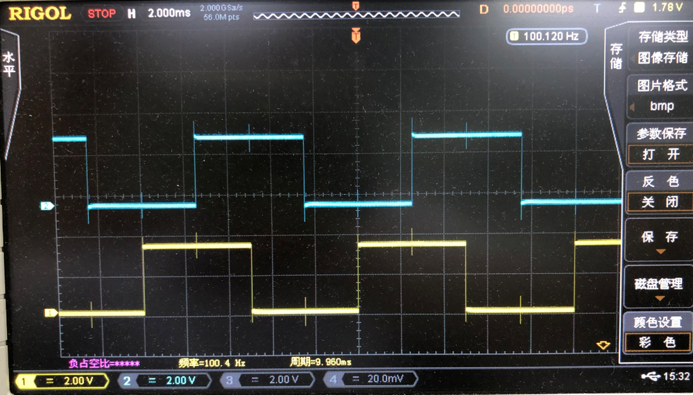

The documentation discusses how to generate phase-shift PWM signals based on SCTimer/PWM module, the code is developed based on MCUXpresso IDE version 10.3 and LPCXpresso5411x board.
The LPC family has SCTimer/PWM module and CTimer modules, both of them can generate PWM signals, but only the SCTimer/PWM module  can generate phase-shift PWM signals.
In the code, only the match registers are used to generate events, I/O signals are not used.
The match0 register is set up as (SystemCoreClock/100), which determines the PWM signal frequency.
The the match1 register is set up as 0x00, which generate event1.
The the match2 register is set up as (SystemCoreClock/100)/2;, which generate event2.
The duty cycle is (SystemCoreClock/100)/2-0x00= (SystemCoreClock/100)/2, which is 50% duty cycle, the cycle time is (SystemCoreClock/100).
The event1 sets the SCT0_OUT1, event2 clears the SCT0_OUT1, so SCT0_OUT1 has 50% duty cycle.
The the match3 register is set up as (SystemCoreClock/100)/4;, which generate even3.
The the match4 register is set up as 3*(SystemCoreClock/100)/4, which generate event4.
The duty cycle is 3*(SystemCoreClock/100)/4  -  (SystemCoreClock/100)/4= (SystemCoreClock/100)/2, which is 50% duty cycle.
The event3 sets the SCT0_OUT2, event4 clears the SCT0_OUT2, so SCT0_OUT2 has 50% duty cycle.
The phase shift is (SystemCoreClock/100)/4 - 0x00= (SystemCoreClock/100)/4, which corresponds 90 degree phase shift.

The Yellow channel is PIO0_8 pin output signal, which is SCT0_OUT1 PWM output signal.
The Bule channel is PIO0_9 pin output signal, which is SCT0_OUT2 PWM output signal.
