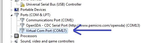

It looks like enumeration went ok COM17 appeared in the device management window:

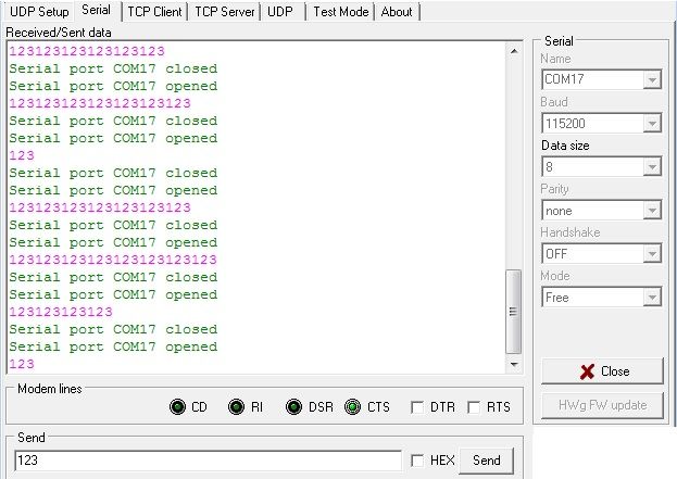

But i can't get any echoed message from it:
(income messages would be black colored, violets are output messages)

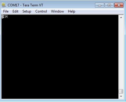

Hello Alexey,
please do you have the same results in Tera Term?

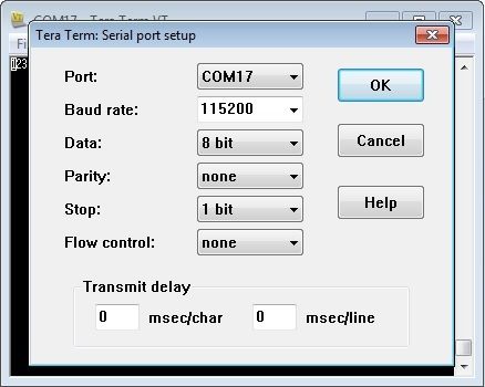

I dont use Teraterm so can't undertand the result. When I've typed 1234 the cursor came back and did not go to new line.

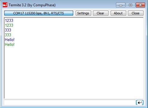

ivadorazinova
Hello Alexey,
I agree with Konstantin.
Please try to set Termite:
Please let me know, if it works you now.
Thank you.
Iva
2,806 Views
alexeyusoltsev
Well!
It worked! Werid that hercules has rts/cts controll too and failed on it.
I thought that
static bool start_transactions = TRUE;
would desable rts/cts control. How can it be desabled?
Thanks for responses! It helped me a lot and now I cant try to modify basic application for my usage.

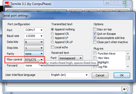

PitOn
Hi,Alexey.
Set the Flow Control from "none" to "RTS/CTS".
