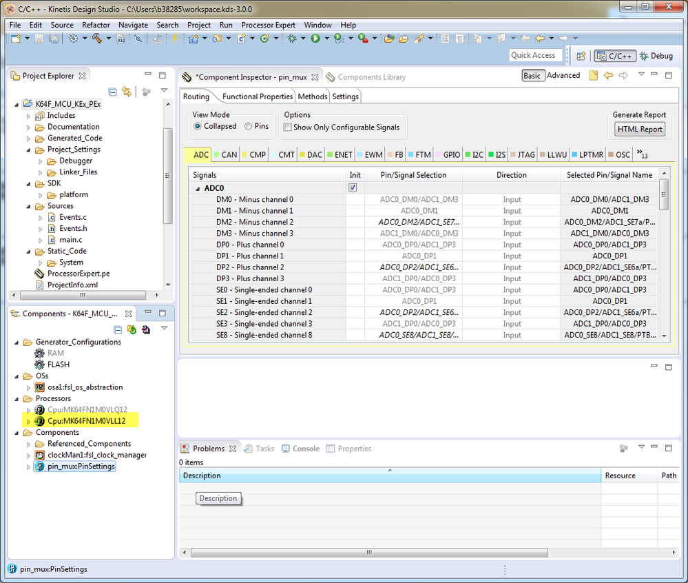

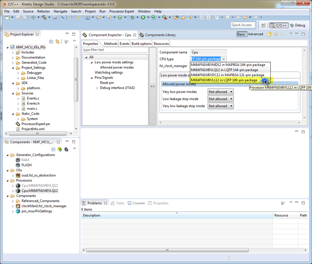

I tried to reproduce what you mention, generated a KSDK 1.3 package for the MK64FN1M0xxx12 and created a new project based on this package with Processor Expert enabled. After that I went to the Cpu component inspector and changed the CPU package:
An error message showed up in the pin_mux component so I clicked on Switch Configuration:

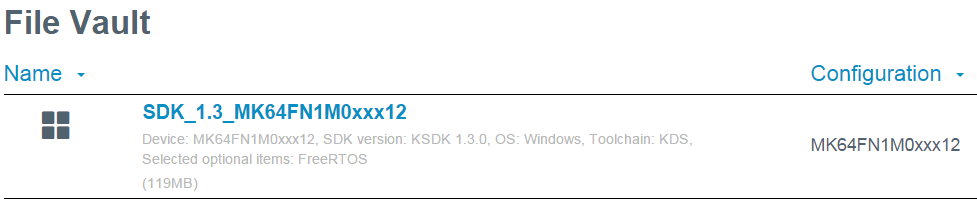

Here is the information of my KSDK package:

Ok, I just went through it again with another part (MK80FN256). Differences from your shots:
I switched the package  in the hardware view, (the mux error was the same. Switch was to the same 100 pin package)
After that it still has this "package" error. The key point -- it's confused about old vs new package.
I can apparently do any of several things to clear the error:
1) Delete the old package from the project.
2) Go ahead and build anyway
3) Exit the program and bring the project up again.
There may be other ways to kill it. It does explain the phantom nature of the error.
