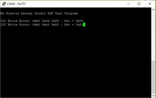

I am continuing my efforts to learn the Kinetis SDK by now evaluating the I2C routines. I have a simple project where I am trying to communicate with a Analog Devices chip at slave address 0xB0.
Here is my code:  ( I am trying to send two writes to the ADI chip. )

I believe I am getting a Nak back from the ADI chip. See below.
Any idea why this code is failing?

Thank you for your response.
You are correct. I am communicating with a slave of address B0. I am writing to address FF and sending the data FF. This particular register is a reset register but I write to other registers that should be holding a value. When I readback from those addresses the status is also 05 - NAK and the data value returned is 0x00.
