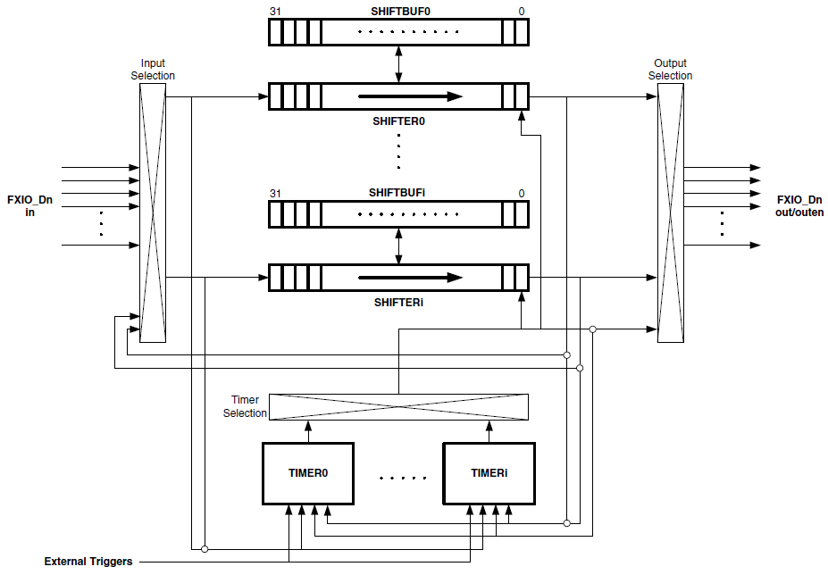

The FlexIO module was first introduced in the Freescale Kinetis KL43 family. It is capable of emulating various serial communication protocols including: UART, SPI and I2C. The FlexIO module is very flexible and you can configure it according to your communication needs. The main components of the FlexIO module are the shifters, timers, and pins. Data is loaded onto a shifter and a timer is assigned to generate the shifter clock and use a pin to output the data from the shifter.
The KL43 FlexIO module has 4 32-bit shifters, 4 16-bit timers and 8 bidirectional I/O pins. Each shifter and timer has its own configuration registers. The most important registers that configure the whole FlexIO behavior are the SHIFTCFG, SHIFTCTL, TIMCFG, TIMCTL and TIMCMP registers. There are other registers that contain status flags, interrupt enabling bits and the buffers for the shifters.
Shifters have a timer assigned to them to generate the shift clock and it can be configured to shift data in or out. When the shifter is configured to transmit mode, the data from the SHIFTBUF register will be loaded to the shifter and the shifter status flag will be set meaning that the shifter is ready to start the transmission. In receive mode, the shifter status flag is set when SHIFTBUF has been loaded with the data from the shifter, and the status flag is cleared when the SHITBUF register is read.
The timers are highly configurable, they can use external or internal triggers to generate certain conditions to reset, enable and disable the timer. The triggers can be a timer output, shifter status flag, pin input or an external trigger input. They can be configured to enable in response to a trigger, pin or shifter condition.
Each shifter or timer can be configured to use any FlexIO pin with either polarity. The pins can be used as an input or output. A pin configured as an input for a timer can be used to receive a clock and use it as the shifter clock that is assigned to this timer.
Once everything is configured you need to read/write the shifter buffers and the shifter and timer status flags to start a transmission or to read the contents of the shifter buffer when receiving data.
The following diagram gives a high-level overview of the configuration of FlexIO timers and shifters.
Figure 1. FlexIO block diagram

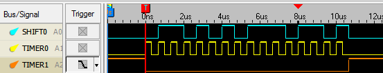

In the following example configuration, the FlexIO module will be configured as a transmitter. It will use one shifter, two timers, and three pins. The pins will be used for the outputs of the shifter and the two timers. One timer will be used as the shifter clock and the other timer will be used as a chip select to show when a transmission is being made. The FlexIO will be configured to have a baud rate of FlexIO clock/4 and will do an 8-bit transmission.
Figure 2. Example transmission

The FlexIO module supports automatic start and stop bit handling. All you have to do is change the SHIFTCFG and the TIMCFG configuration bits. In the SHIFTCFG register set SSTOP to 11 if you want the stop bit to have the value 1, and set the SSTART to 10 if you want the stop bit to have the value 0. In the TIMCFG register set the TSART to 1 and the TSOP to 10.
The transmission will look as the following image. Data transmitted 0x0F.
Figure 5. Transmission with start and stop bit

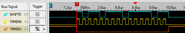

Changing the phase of the clock is very easy, you just have to set the TIMPOL bit to 1 in the SHIFTCTL register.
Figure 6. Shift on negedge of Shift clock

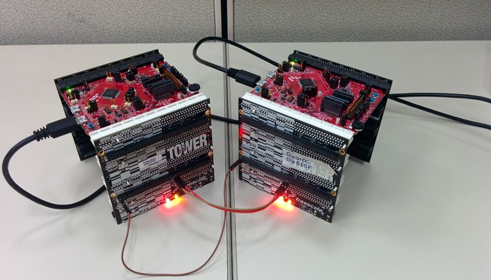

The hardware connections are shown in the following table.
Signal name
TWR-KL43Z48M transmitter
TWR-KL43Z48M receiver
Pin name
Board Location
Pin name
Board Location
Serial Data
PTD0/FXIO0_D0
B46
PTD0/FXIO0_D0
B46
Clock
PTD1/FXIO0_D1
B48
PTD1/FXIO0_D1
B48
Chip Select
PTD2/FXIO0_D2
B45
PTD2/FXIO0_D2
B45
GND
GND
B2
GND
B2
Table 1. Hardware connections
Figure 8.

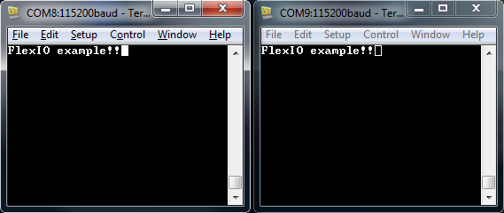

The example projects for the FlexIO transmitter and receiver are developed in KDS 3.0.0 with KSDK 1.2.0. The application lets the user communicate with the transmitter via a serial terminal and the transmitter sends each character to the receiver via FlexIO and the receiver displays the received character on another serial terminal.
To be able to compile the project, first you need to compile the library located in C:\Freescale\KSDK_1.2.0\lib\ksdk_platform_lib\kds\KL43Z4.
Once the two TWR-KL43Z48M are connected as described above, import both projects into KDS, compile the platform library, and both projects. Open two serial terminals configured to 115200 bauds and run each project on a different tower.
On the transmitter terminal you can write anything and it will be displayed and transmitted to the receiver tower via FlexIO and will be shown on the other terminal.
Figure 9. FlexIO example application. Transmitter (left terminal). Receiver (Right terminal).

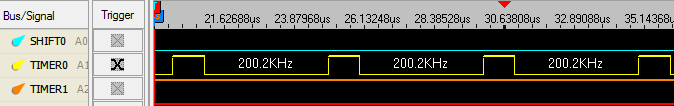

The FlexIO module is also capable of generating a PWM signal by configuring one of its timers to the Dual 8-bit counters PWM mode. This mode is configured by writing 01 to TIMOD in the TIMCTL register. In this mode, the lower 8-bits of the counter and compare register are used to configure the high period of the timer output and the upper 8-bits are used to configure the low period of the timer output. The shifter bit count is configured using another timer or external signal.
To calculate the frequency of the PWM signal you have to add the lower 8-bits of the counter and the upper 8-bits and divide it by the FlexIO clock*2 (Only if the timer is configured to decrement on the FlexIO clock.)
The frequency of the PWM signal is given by:
f = (FlexIO clock)/(TIMCMP[15:8]+TIMCPM[7:0]+2)
To calculate the TIMCMP values to get a certain frequency you can solve the equation for TIMCMP
TIMCMP[15:8]+TIMCPM[7:0] = (FlexIO clock)/f-2
For example, let’s say we want a 200kHz PWM signal, by using the formula above and using the FlexIO clock of 48MHz, we get that the sum of the TIMCMP values must be 238. If we want a 50% duty cycle we need to write the value 238/2 to the lower and upper 8 bits of the TIMCMP register.
The waveform generated by these settings is shown in the figure below.
Figure 10. 200kHz 50% duty cycle PWM signal
To change the duty cycle you need to change the values of TIMCPM[15:8] and TIMCPM[7:0] but without changing the sum of both values, otherwise the frequency will also be altered. For example, if we need a 20% duty cycle we multiply 0.20*238 and 0.8*238. We round up the results and get TIMCPM[7:0] = 48 and TIMCPM[15:8] = 190. The waveform generated will look as shown in the figure below.
Figure 11. 200kHz 20% duty cycle PWM signal

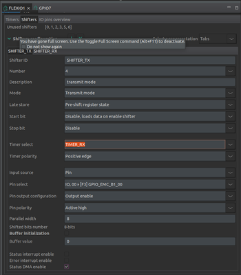

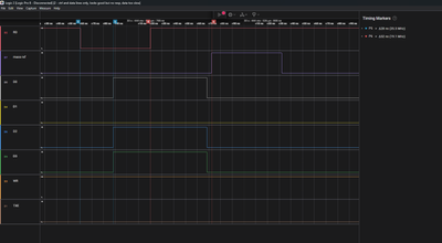

This is the screenshot of the logic analyzer capture. I want the
