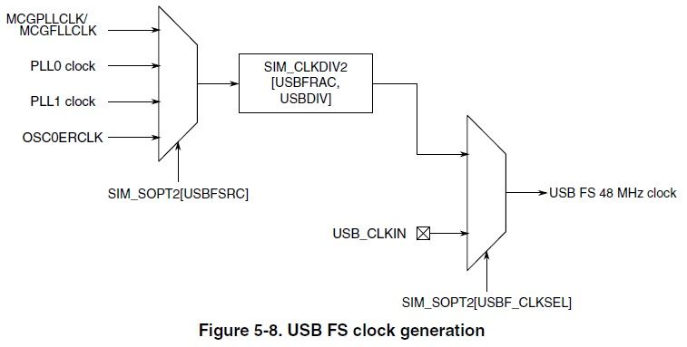

I'm tis K70 150MHz.
By default, Bus Clk is 120MHz in MQX.
for that, in init_gpio.c, _bsp_usb_io_init, the USB clock is initialised like this:
      /* Configure USB divider to be 120MHz * 2 / 5 = 48 MHz */
       SIM_CLKDIV2_REG(SIM_BASE_PTR) &= ~(SIM_CLKDIV2_USBFSDIV_MASK | SIM_CLKDIV2_USBFSFRAC_MASK);
       SIM_CLKDIV2_REG(SIM_BASE_PTR) |= SIM_CLKDIV2_USBFSDIV(4) | SIM_CLKDIV2_USBFSFRAC_MASK;
Now, I change CLock configuration to have Bus Clock to 150MHz.
So If I keep this USB init, USB clock will be 50MHz instead of 48Mhz which is the maximum USB frequency.
But When I change SIM_CLK2 register FSDiv and FSFrac to adapt frequency to lower, USB not work!
I test many value.
Exemple:
        SIM_CLKDIV2_REG(SIM_BASE_PTR) |= SIM_CLKDIV2_USBFSDIV(4) ;
To obtain 150Mhz * 1 / 5 = 30MHz, but not work!
Are they a value which work with 150MHz busClock??
Thank
4,355 Views
arnogir
Senior Contributor II
Ok After test, all work correctly now!
Like PLL0 was no more use to generate MCGOUTCLK, we must activate it.
So use PLL0 at 120MHz for USB only and PLL1 for DDR and LCGOUTCLK was the solution.
Thank for your help

arnogir
Hello
Ok, I think I found where  come from my problem.
Data sheet indicate:
Then If I well understand, the USB FS Clock MUST be exactly 48MHz to Rune correctly. But this frequency is not reachable with a PLL0 Clk source = 150MHz.
So I can used the unused PLL1, configure it to 120MHz then configure USBFRAC/USBDIV to have 48MHz.
In your exemple, The USBCLock source is also the PLL1:
SIM_SOPT2 |= (SIM_SOPT2_USBSRC | SIM_SOPT2_PLLFLLSEL | SIM_SOPT2_USBFSRC_MCGPLL1);
But you do not show how is configured the PLL1. I think the Output frequency of PLL1 should be equal to value of USB_CLOCK_SOURCE. (You do not show its definition) According final value ([0x04]) it seem your PLL1 is set to 96MHz?? (x2 / 4 = 48MHz)

arnogir
=> It seems the PLL1 is used for DDRClock. And in BSP it is configured to 150MHz I think...???
So the first idea is to used PLL1 which is already set to 150MHz to used it also for the MCGOUTCLK (Core clock). (MCG_C11.PLLCS bit set to 1...) So the PLL0 will only used for the USB set to 120MHz. (PLL0 can also be used by LCDC and SAI, but I not use SAI and LCDC module is on BucClock)
4,355 Views
