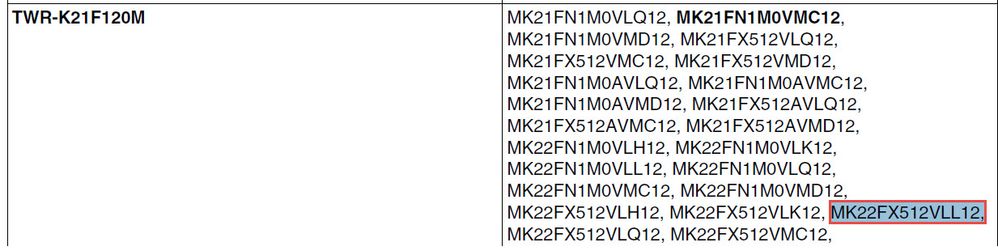

How are you? Hope you are fine! KSDK 2.0 has support for MK22FX512VLL12 device. You can use USB examples for TWR-K21F120M board which is compatible with K22FX512VLL12.
There are several USB Host examples for different classes  such as HID, MSD, CDC, etc. You can locate them at: <SDK_2.0_MK22FX512xxx12>\boards\twrk21f120m\usb_examples.

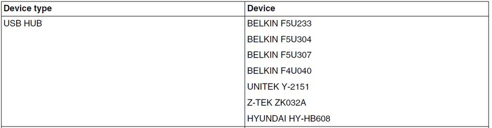

Also, in KSDK 2.0 documentation, it is stated that some external HUBs (not IC HUBs as your customer wants to use) were tested on these examples:
But basically there should be no problem when using this IC HUB (Customer should implement the serial communication between K22 and IC HUB through serial interface).
