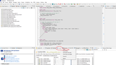

I have a project that was originally done in KDS, but now I want to migrate it to the MCUXpresso environment. For now, I am ignoring what I did in the past and just learning the MCUXpresso way.
My problem is that I don't want the debug console that seems to be required by the SDK Managment tool.
How can I formulate a basic system without it?
Thanks for any pointers.

It appears that XiangJun Rong misunderstood my situation. My concern was the console software routines that seemed to be always included in a project.
What I have found is that when you start a new project, after selecting the processor, in the next window at the upper right is the option to select either the "Semihost" or "UART" for the SDK Debug Console. When I started a new project and selected "Semihost", I got what I needed.
In going through the "SDK Management" selections, I couldn't find where this could be changed. So, it is important to make this selection at the very beginning.

Ir appears that the Console menu is part of MCUXPresso IDE tools, you can click "close" to close the Console window.
Pls have a try.
Hope it can help you
