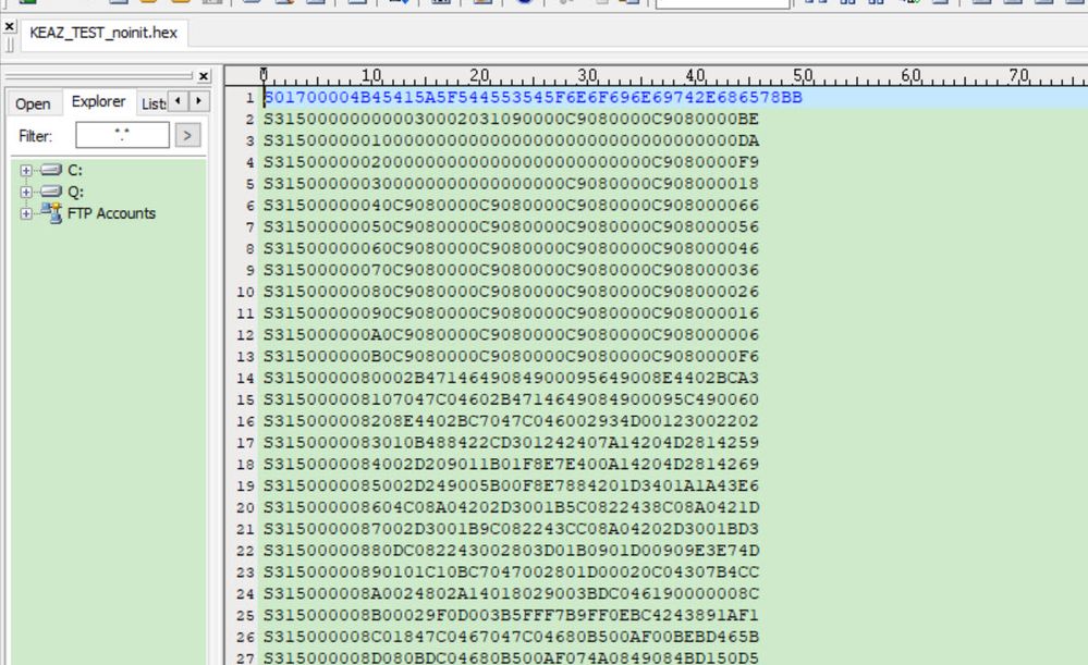

          I use MCU : KEAZ128, I need noinit data function.   I refer to this example  https://community.nxp.com/t5/S32-Design-Studio-Knowledge-Base/EXAMPLE-S32K144-noinit-section-usage/t...
       The noinit fuction is ok.  but the flash image file (.hex)added the following lines:
        "S3111FFFF000000000000000000000000000E0"
I need to delete these lines manually, which is very troublesome.
How can I automatically remove these lines?

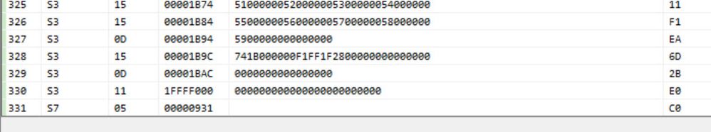

        What I want to ask is that s19  file contains the address of ram instead of flash address.( S3111FFFF000000000000000000000000000E0).
      When I want to give this file to my client, I have to delete this line manually. I find it very troublesome.
So I want to ask, how can I delete this line, automatically.

   Your code in the srec: S3111FFFF000000000000000000000000000E0,
   It is totally generated by your divide the my_data section, which is used as your nonint area.
   This section data is generated by the CW.
   If you don't want to get this area bin code, you can delete all you my_data sections in the link, and the myRAM in your main.c. That will generate the no code about:
   But, if you still need this function, I think you may checking it in your client, when readout the flash address 1FFFF000, just ignore this frame data.
   Just from the CW side, I didn't find any othe way to delete it, except delete your link related section allocated code.
