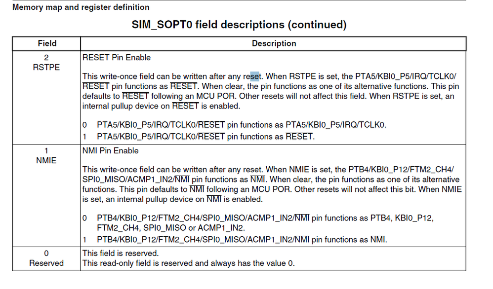

I'm using MKL17z128VFM with MCUXpresso 10.3.
I would like to use it by setting the reset pin as the IO pin.
How can I do it?
1,548 Views
nxf58904
You have to set 0 to reset pin enable .And then configure this pin as GPIO.
SIM->SOPT = SIM->SOPT & (~SIM_SOPT_RSTPE_MASK),put this function in front of main().

Question for @nxf58904 ,
Is it possible to use the Reset Pin as PTA5/KBIO_P5/IRQ/TCLK0 but still have the pin available for device programming?
If so, what are the guidelines for wiring the pin (ie only as an input (DI or IRQ))?
I'm always IO limited, so I'm looking to see how to use every pin possible.
myke
1,526 Views
nxf58904
Hi,Because it will be reset_b after  reset, we configure it as gpio for using. So,if we want  to  use  it as tclk0,we have to configure it as tclk before we use it .
