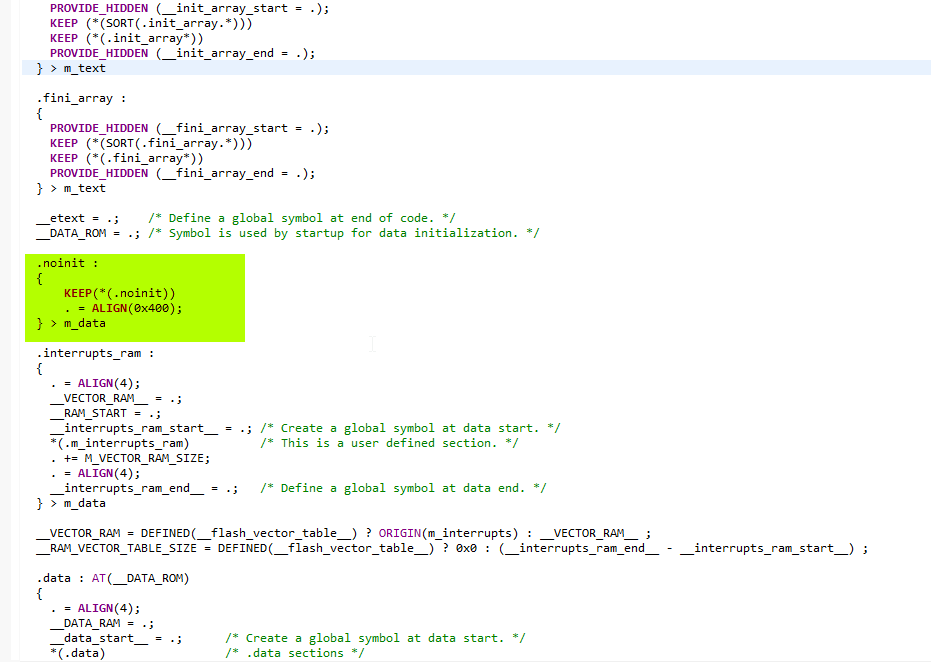

After startup - uninitialized RAM is set to 0 by startup code (startup_S32K144.S). If you need access to data stored in the RAM after reset is performed, you can  add these variables into .noinit section. You need to update your linker file and add .noinit section aligned to 1024 bytes before _RAM_START is defined:

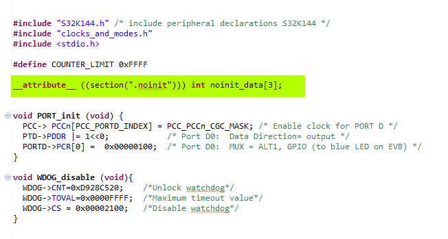

In code assign your variable into .noinit section:
Example usage:

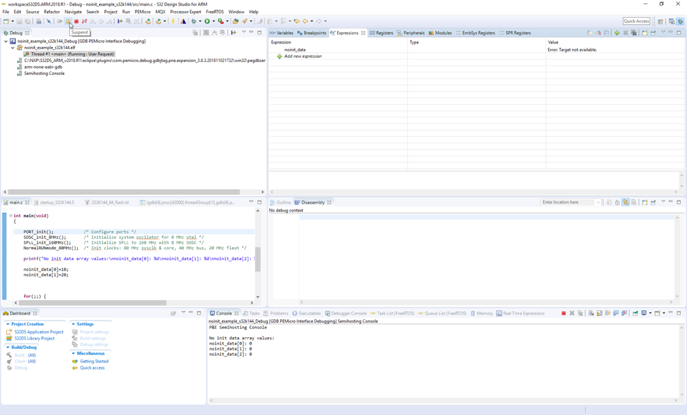

Import attached example into S32DS for ARM, build in and start debug session. Resume target
and suspend program execution:
In semihosting debug console you can see that noinit_data are set to 0. The board is in state after power ON:
Reset board and let's check if data remains in RAM memory:
After resume, you can see in semihosting console (or expressions view), that data remains unchanged:

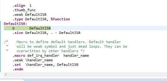

Hi Jiri Kral,
 I followed all the above steps of Noinit example in my project.But my code is stuck in default ISR as show in the image.I am using s32DS and s32k144 contoller. I would greatly appreciate it if you could help me with this.
there is a bug in example - .noinit section needs to be aligned to 0x400.
Jiri

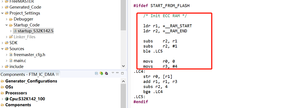

Hi Jiri,
    I have diffrent opinion. At startup code, S32K will Init ECC RAM and it will clear all RAM(_RAM_START  to _RAM_END) . So,when I reset S32K, the Value is 0.
This code is jump !
