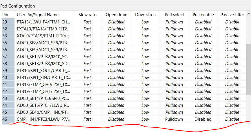

I checked the referenced component 'Pins' and it leads me to my general IO component for PortD. Below is what 'Pins' displays.
But nothing really shows up here. Port D pin 2 (pin 59) shown. I think it must be something with the wake-up pin.
Below is the Pin settings again under the wake-up. P13 (pin 59) is not assigned.
My guess is that it thinks Pin 59/60 are in use because the current IO pin has it mux'ed to be used elsewhere such as the wake-up pin. However, I am not sure how/where to resolve this.

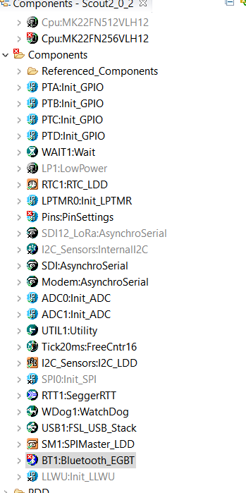

Below is an image of my project obviously more components. There is a LLWU component, but it is not enable and I've deleted it and it still has that issue. Could you try and and GPIO port D component?

   From your description, your other component should also use the PTD2 and PTD3, that will cause the problem.
   You said you select the LLWU, but you didn't enable it, you can delete it, I find your BT1 also have problem.
   If you are convenient, you can share your problem project, I will help you to check it.
   From you first post, the error is caused by the difference component pin conflict.
Kerry

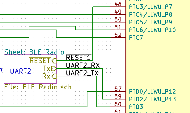

The Bluetooth is the component that I added and I am trying to get to work, and also be able to have the other components. Am I just not able to have both Bluetooth and GPIO components in the same project?
On kind of a side note, I am a bit unfamiliar with this method of setting registers, but I want to turn Pin 46 PTC3 on and off with these macros. (Where can I reference these register settings?) They don't appear to be effective. I confirmed on my scope. Any thoughts?

kerryzhou
Hi Christopher Burg,
    Yes, you are right, PE component can't select two component with the same pin.
   But if in your Bluetooth you just want to control pin PTC3, you totally don't need to use the component.
   You can configure the PTC3 pin as GPIO, and set it to the output, then you can use your
About the PTC3 initialization with register.
  SIM_SCGC5 |= SIM_SCGC5_PORTC_MASK;// enable port C clock gate
  PORTC_PCR5 &= 0xFFFFF0FF;
  PORTC_PCR5 |= PORT_PCR_MUX(1) | PORT_PE_MASK|PORT_PS_MASK;

burgeh
The PORT_PE_MASK and PORT_PS_MASK are not defined. Is there a header file I need to include or where can I find these values? Also where are you referencing to do this?
4,155 Views
kerryzhou
   Don't worry, you also can use these code to replace PORT_PE_MASK and PORT_PS_MASK :
PORT_PE_MASK : (1<<1);
PORT_PS_MASK: (1<<0);
