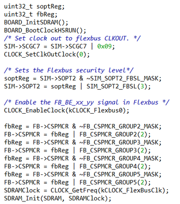

Hi all,
My board using MCU K66FN2M0VLQ18, DRam IS42S16400J-7TLI, IDE IAR Embedded Workbench.
I have init DRam in SystemInit(void):
How to erase internal flash if i using FreeRTOS and Dram?

I suppose that you can download SDK package, in the package, there is flash example.
If you want to erase/program flash in FreeRtos environment, you have to do the following:
1)stop the FreeRtos scheduling with
void vTaskEndScheduler( void )
2)disable all interrupt with code:
__STATIC_FORCEINLINE void __disable_irq(void)
__ASM volatile ("cpsid i" : : : "memory");
3)erase/program flash with SDK example
4)recover the interrupt and FreeRtos scheduling.
Hope it can help you
XiangJun Rong
