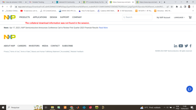

Leonard30
Hi Ludek
I am get a message as this when I try to download the files.
8,291 Views
