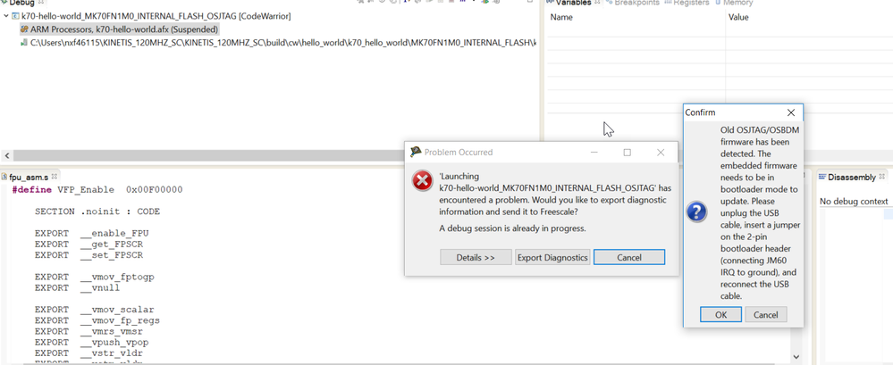

Hi Guys,

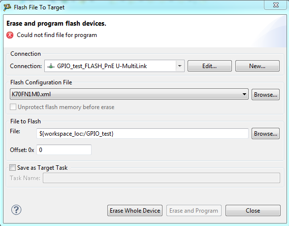

I have twr-k70f120m and twr-ser  boards. At first I tested the democode which was already in the board and it was working fine. I downloaded codewarrior v10.2.2 and erased the chip to flash the new code.
I erased and ran the code in debug mode and the code was executed.
Now if I again flash the demo code into the  chip the code is not working/executing.
I want to again flash the demo code which had the #memory game, accelerometer, touch led on/off.
Can anyone please tell me how to flash it and why the board is not working even after the code flash is successful (image 2)?
Also the reset led (D2) is partially on all the time and it glows brightly when I press the reset button. Is it the normal behavior or is there anything wrong with the board?

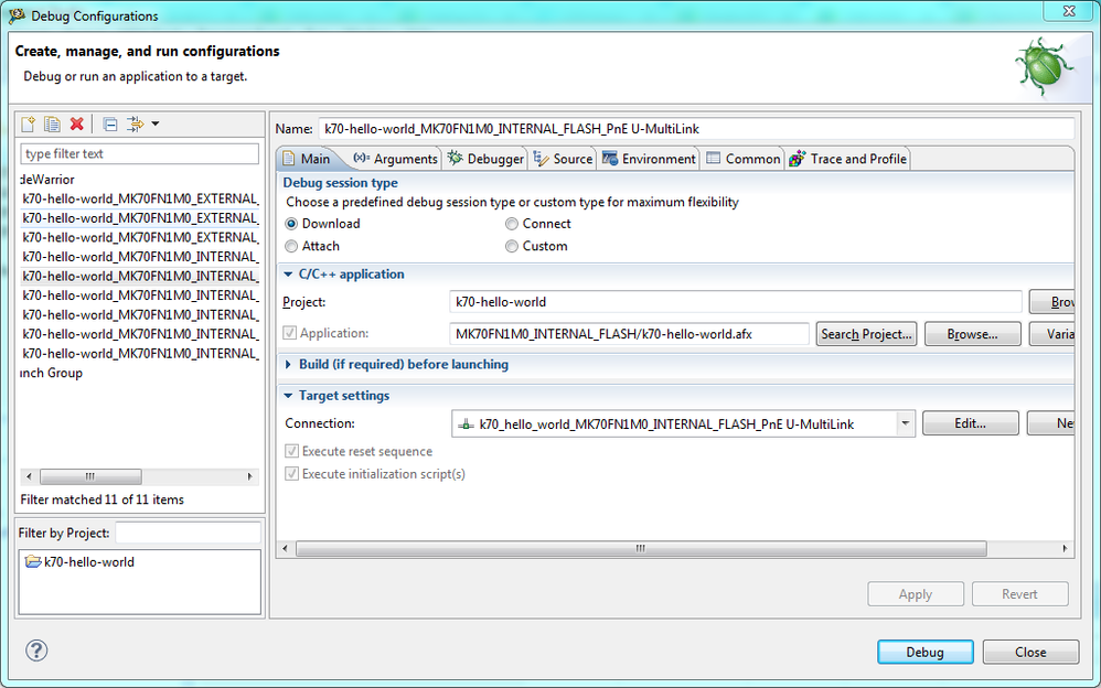

FelipeGarcia

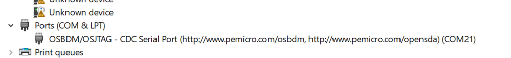

Hi Vibhu,
How is your device being enumerated? It should look as follows:

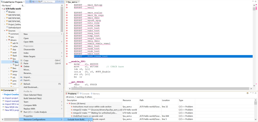

Then, please make sure your project compiles correctly, to do this you need to create your workspace into the Kinetis_SC folder. Just as the readme you mentioned indicates.
It is likely that the project shows some errors when trying to build it. Please do as follows in the same image.
After that you shouldn’t have any issues to build the project.
When trying to debug I receive the following message.

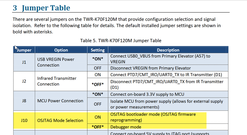

This tells me that I need to update the firmware of OSJTAG. To do this I need to connect my board in bootloader mode. Please follow the next steps in order to do the update.
-Disconnect you board.
-Place a jumper in J10 (please check the following snippet from User Guide).
-Connect the board again.
-Click OK in the Confirm message.
Once the firmware has been updated you need to go back to debugger mode, to do this you should do the following.
-Remove the jumper in J10.

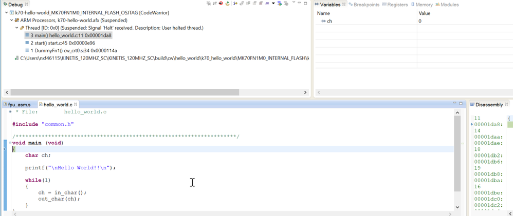

After following this steps I was able to flash my TWR-K70F120M. Please let me know if this helps.

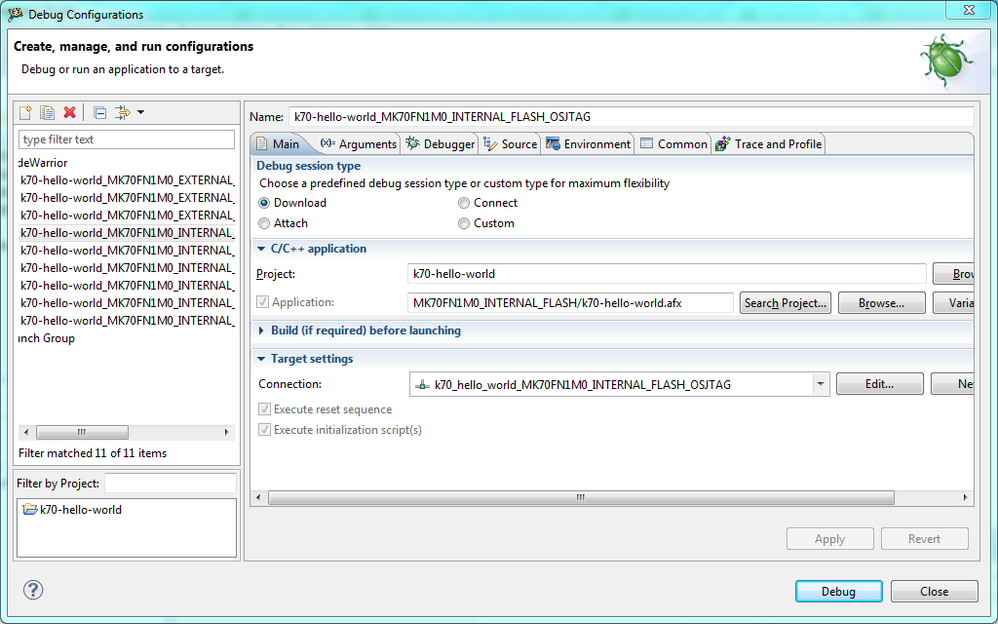

Thank you for your suggestion. I downloaded the latest version of the CodeWarrior as mentioned by you and also I downloaded the KINETIS_120MHZ_SC. I followed the readme given inside the build for cw which I have attached. I imported the project and gave build as mentioned in point number 4 but there are no console prints for building or whether it has built.
I continued to step 5 and it is throwing error while debugging.
I selected the above configuration OSJTAG.
I got an error.
I re-selected the configuration to PnE U-MultiLink.
But again I got the same error.
Nothing seems to work. Where am I possibly wrong ?
I am not able to program in keil also.
Please Help :smileysad: !

vibhu
Hello Felipe,
Thank You for the help.
It was giving errors and was not able to build because it was inside two sub folders. I copied it into desktop and tried the way you told and it worked like a charm :smileyhappy:
