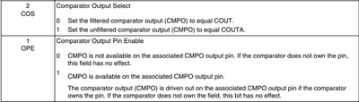

With the FRDM-KV10 evaluation board I am able to check the operation of the CMP0 comparator by scanning the CMP0_SCR_COUT bit (switching of the FRDM-KV10 red LED) which validates the configuration of the inputs and the operation of the comparator.
BUT I can't get the comparator output to the PTC5 pin (which is frustrating when you want to have hysteresis set by external resistors).
Is this 3 instructions enough to have the output on PTC5 :
  ldr r0,=0x4004B014 //Pin Control Register n (PORTC_PCR5)
  ldr r1,=0x00000640 //PTC5 alt6 CMP0_OUT
  str r1,[r0]
Please see the "very little" assembler attached source file (I had to change the .S extension of the file for it to be attached).

Yes, you must also put CMP0_CR1_OPE=1 to have the output redirected to a PAD/PIN. Now it works. Thank you for your attention.

Unfortunately we do not have an SDK example that shows how to use the Comparator Output (CMPO), there is just the cmp_interrupt and cmp_polling examples.
However to set the CMPO you just need to use the following registers:
Hope it helps you.
