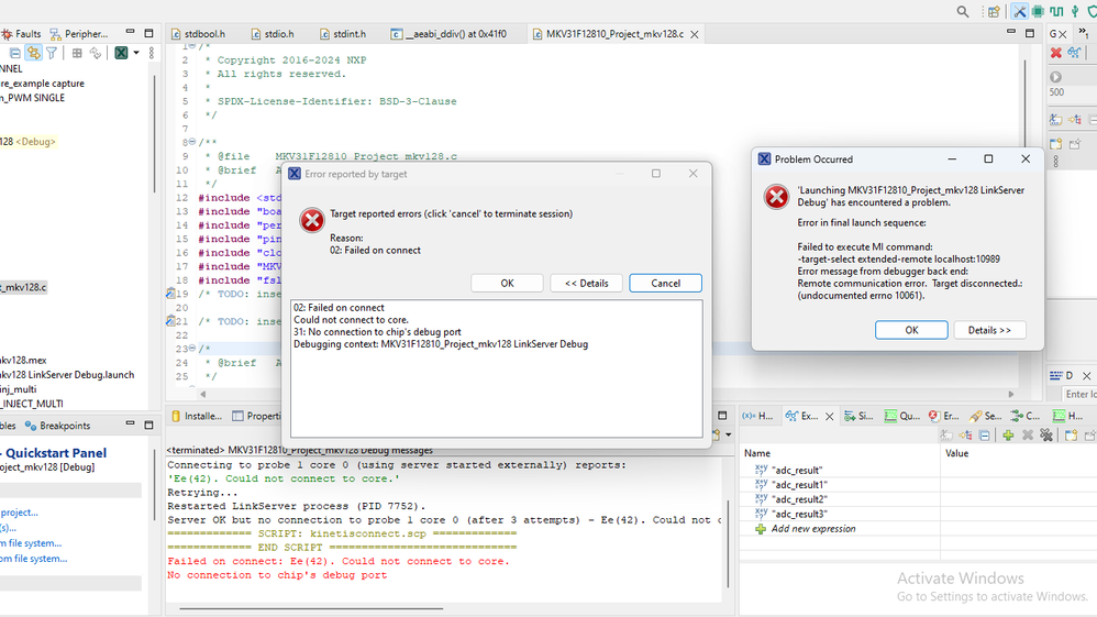

Failed on connect: Ee(42). Could not connect to core.
3,119 Views
pandi
We trying connecting MCU-link we are getting the following error MicrosoftTeams-image (3).pngMicrosoftTeams-image (2).png
We also installed driver software MCU-Link from the NXP https://www.nxp.com/design/design-center/software/development-software/mcuxpresso-software-and-tools...
although we installed all the software needed for MCU-link we are same  above mentioned error repeatedly  how to solve the problem and ?
In KV31 for  supported or not MCU-link debugger?
                                 Thank you

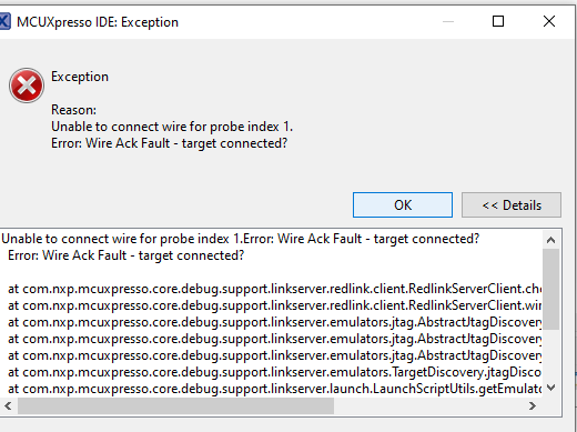

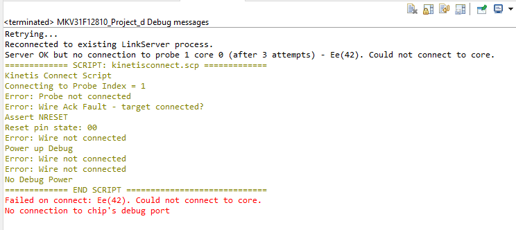

pandi
@Pavel_Hernandez
We are using PCB board to MCU-link debugging that time facing following error Screenshot 2024-04-01 130134.png
connection its correct .how to solve the problem?
PANDI
3,072 Views
Pavel_Hernandez
Hello, my name is Pavel, and I will be supporting your case, could you let me know if you are using the TWR or is a custom PCA? if you are using the EVK, are you using this connector?
Your issue showed appears when the MCU is not halted by the debugger, could you try to do a mass erase? and flash it again.

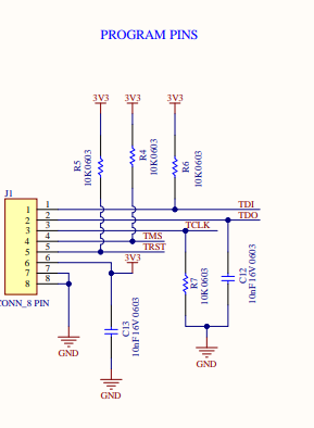

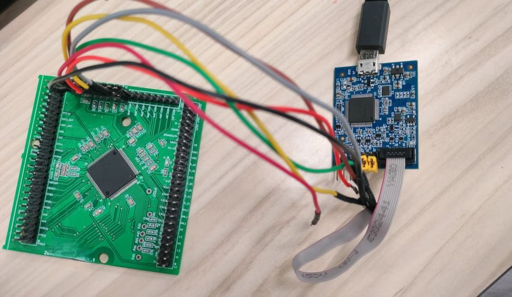

@Pavel_Hernandez
We are using mkv31f128vll10 Processor for  making PCB board trying to flash code MCU-Link
 All the wire connection needed for MCU-link are  given correctly but we are same  above mentioned error repeatedly. Help us in this regard. Whether MCU link is compatible with mkv31f128vll10 Processor ?
2,955 Views
Pavel_Hernandez
Hello, thanks for the helpful image, your issue is your cable for communication these communications in all boards are nearest to the MCU and our cable is too long maybe the Z impedance is too High. I recommend using the flat cable only for this communication.
