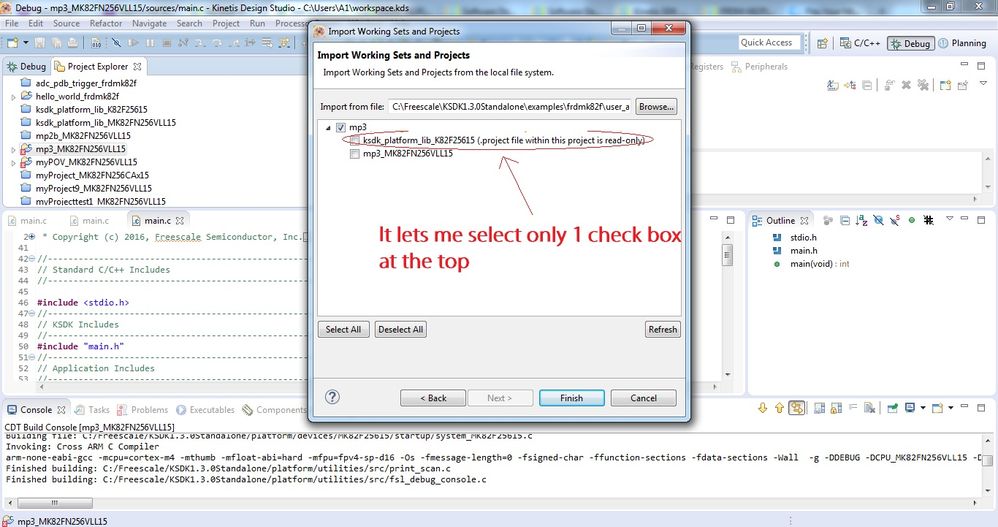

I import it from File>Import (in KDS ver 3.2)
Now I a using KSDK1.3.0Standalone (as this is a version for which the project gen works)
I get this screen

When I build the project I get the error
make: *** No rule to make target '../../../../../../lib/ksdk_platform_lib/kds/K82F25615/debug/libksdk_platform.a', needed by 'mp3_MK82FN256VLL15.elf'.
When I do a debug I get the error
Program file does not exist
C:\Freescale\KSDK1.3.0Standalone\examples\frdmk82f\user_apps\mp3\kds\debug\mp3_MK82FN256VLL15.elf not found

Hi ALok,
The error message "No rule to make target '../../../../../../lib/ksdk_platform_lib/kds/K82F25615/debug/libksdk_platform.a'" means the library file libksdk_platform.a is missing, and that is likely because it was not built.  You should be able to import the library project into KDS, located at C:\Freescale\KSDK1.3.0Standalone\lib\ksdk_platform_lib\kds\K82F25615.  Once you build that, KDS will generate the libksdk_platform.a library file.  And then you can build your mp3_MK82FN256VLL15 application project.
You can also refer to the KSDK Getting Started guide installed with KSDK at <KSDK Installation path>\doc\Getting Started with Kinetis SDK (KSDK) v.1.3.pdf.  It includes the details steps for using KDS to build the KSDK library and application projects.
