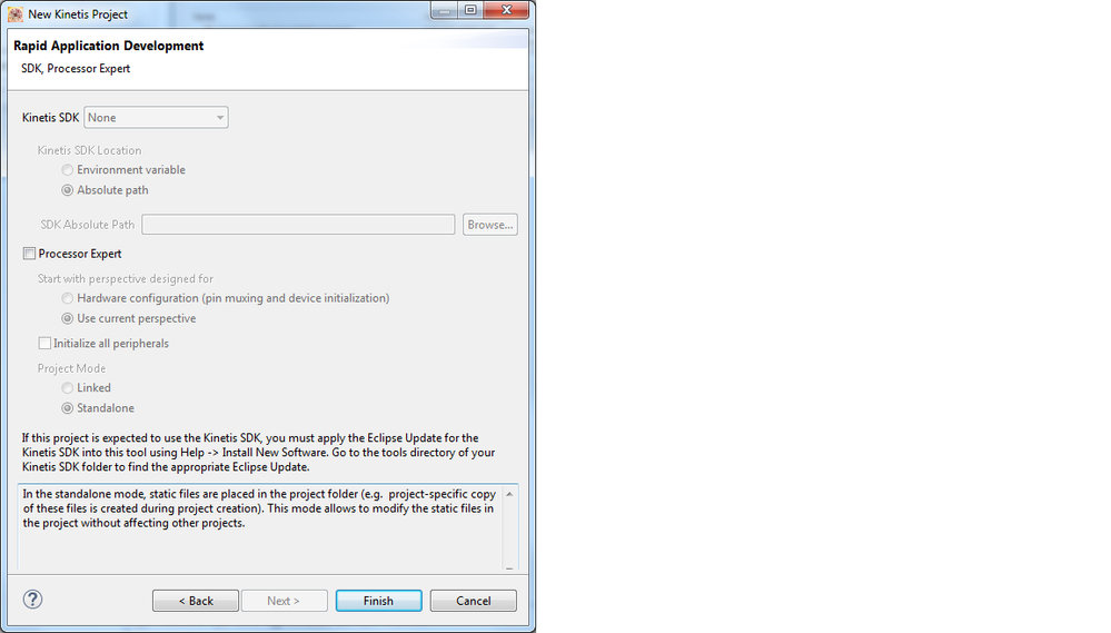

stephenspears
I have a new installation of KDS Studio 3.0.0 and have followed the Getting Started with Kinetis SDK Guide for adding the Kinetis SDK.  I have the FRDM-K64F board.  When I try to create a new Kinetis project it does not seem to have any knowledge of the SDK being loaded.  After many searches I am suspicious of environmental variables or paths.  I don't seem to have a KDSK_PATH variable defined that I have seen other people have.  Is this something I should create manually or did I miss a step somewhere?  I also see that I don't have ${eclipse_home}\..\toolchain\bin defined in my Path.  I hope these clues can point to something I have missed.  I did 'install new software' to load the KSDK 1.2.0 Eclipse Update.
Thanks.

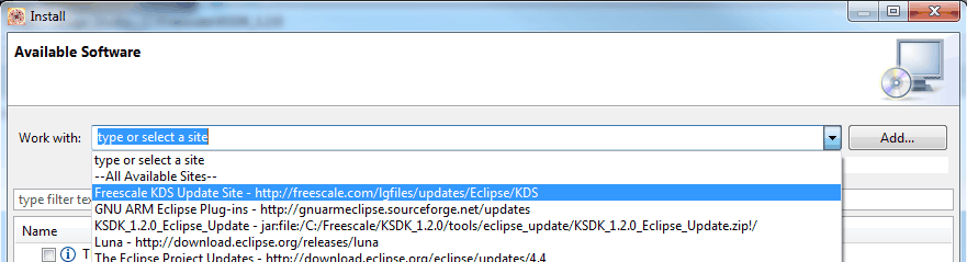

DavidS
Hi Stephen,
Have you associated the KDS with the KSDK by doing the Help->Install New Software...  steps?
If not, please review Chapter 4 of C:\Freescale\KDS_3.0.0\doc\KDS_Users_Guide.pdf
After doing that, please also repeat the Help->Install New Software... step to get online updates for KDS/KSDK that are essential.
Then click the "Select All" button, and follow wizard instructions.
David

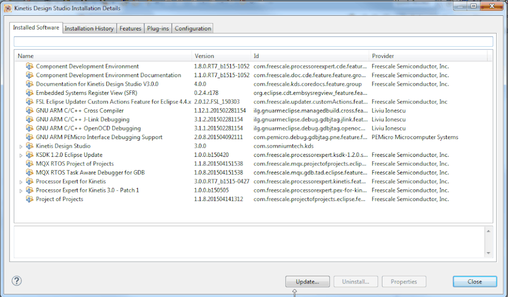

stephenspears
Hi David, I have already done that.  Everything is installed and updated.  See if anything is missing:

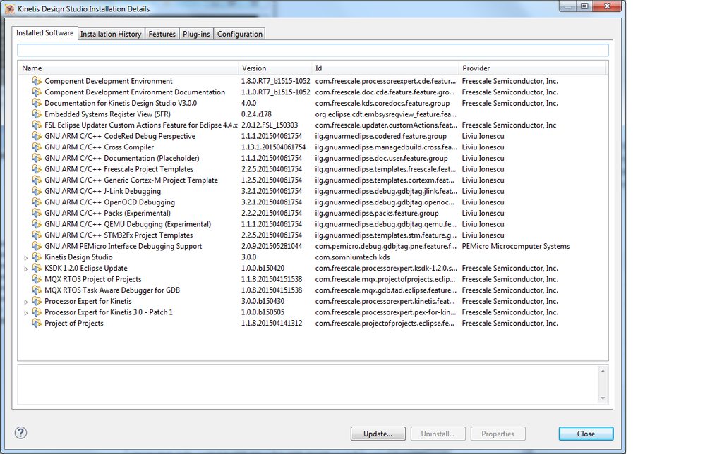

DavidS
Hi Stephen,
It looks like you might have done the Help->Check for Updates.
This is a no no so to speak.  "Check for Updates" is checking to see if their are Eclipse updates and not if their are Freescale updates to apply to the specific KDS install.
Since Eclispe is Open Source project, that menu item is present (and I'm guessing there might be some case where you want to do that update).
Can you try to un-install the plug-ings not show in my below image and re-test?  I'm guessing they might be the issue.
David
3,068 Views
stephenspears
David,
My Installed Software list looks like yours now.  The Kinetis SDK is still grayed out for the FRDM-K64F.
