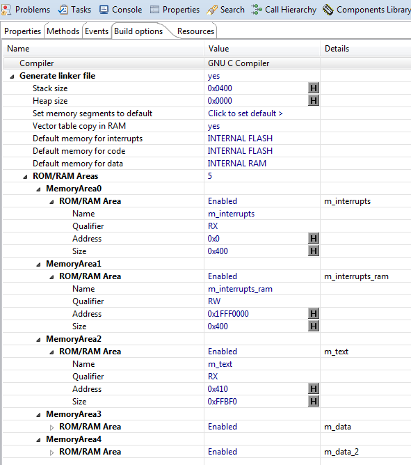

I have read Erich Styger's blog Debugging Hard Faults on ARM Cortex-M | MCU on Eclipse regarding the creation of a separate fault handler for each fault type.  Admittedly, I never actually used them in my previous project under KDS2/KSDK1.1, but I did see the option to select "own handler" in the Build Options for the CPU settings in PEx.
I'm trying to debug a problem with my application, and want to be able to see what sort of fault it's encountering, but I cannot find this PEx setting in KDS3/KSDK1.2.  This is what I see:
Does anyone know what we are supposed to do in the new IDE?

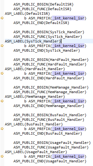

Thanks, Erich.  That does help for sure.  But now I just have to figure out how the fault handlers work.  It does look like all of them point to the same handler (_int_kernel_isr), so now I'm just wading through code to see how I'm supposed to trap the error.  I'll try making my own functions and see if any of them get called -- at the moment, it appears that there isn't a fault that's causing my code to stop executing.  I'll post my findings.
EDIT - I was expecting the fault handlers to call _int_default_isr...
I guess this implies that I need to read up on these macros -- elsewhere in the code it looks like _int_default_isr is intended for unhandled exceptions.  So I put a breakpoint there and it does hit it.  So this means my application did stop due to an unhandled exception, so now I just have to figure out which one.
EDIT - BlackNight​ looking at startup_MK64F12.S, I see the list of vector numbers.  Being mostly assembly-illiterate, I took this info:
and working backwards up the list, it looks like NMI_Handler would then be 0.  When I hit the breakpoint in _int_default_isr, it looked like the unhandled exception had a vector number of 3, which is BusFault_Handler.  Reading dereksnell​'s post Tracking down Hard Faults , it sounds like it's likely an invalid memory address that's causing my problem, which sounds right since merely calling netconn_accept() (modified to simply return 0) causes the crash to occur.  He said it could also be accessing a peripheral register before the clock is enabled, but I don't think this is the case since I can ping the device up until the point where I call netconn_accept.
Can you recommend any other debugging strategies?  In the meantime, I will try to decipher your post Debugging Hard Faults on ARM Cortex-M | MCU on Eclipse  to see if I can determine what causes the memory corruption.
