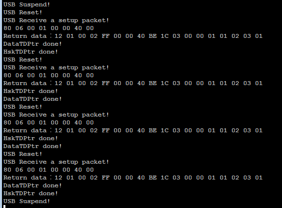

Hi:
We just have a board with the processor type MK64FN1M0VLQ12. And we use the KDS processor expert to generate the module low level drivers.
But it has a problem as follows.
When we want to test the USB interface,we call the functions supported by the USB1.c just like the help document says,but I found it can not enum
my device.
I can receive the first setup packet from the host .It request a device descriptor,and I send my descriptor to the host. Next to it ,I found the host reset
my device and request a device descriptor again. I send my descriptor again,and the host reset my device.
The host reset my device 4 times and the suspend it.Why?
I think the host will send a set address request following the device descriport request,but I never receive it.
Can anyone help me?Thanks very much.

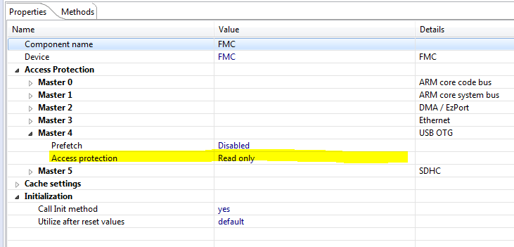

I'm checked attached project. I found two significant problems:
1) USB descriptors (Device, Configuration, ...) are placed in Flash memory area.
USB module access to flash memory is through AXBS module. In AXBS module, access between USB module and Flash memory area is disabled (after MCU reset). For configuration USB memory access is possible to use "Init_FMC" component (by "Access protection" property - set to "Read only" value for Master4/USB OTG module):
2) Problem with MCU BUS priority.
In main() function is code:
=> In this case is MCU internal BUS "fully" allocated by MCU ARM core. After MCU reset, ARM code BUS has maximal priority = 1 and USB OTG module = 5.
For BUS priority configuration is possible to use "Init_AXBS" component and set properties "ARM core code BUS" = 5,  "USB OTG" module = 1 (e.g.):
Fixed project is attached.
Jiri Rezler

haibodeng
Hello:
Thanks very much.Your answer fully solve my problem.
