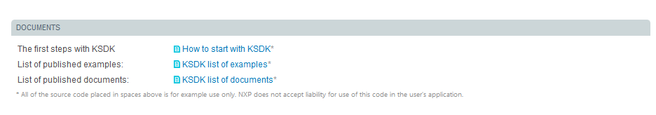

All your questions regarding KSDK you can ask on Kinetis Software Development Kit​
You can also find helpful these examples on the KSDK Community.
