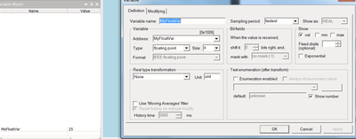

My var is defined as a float in FreeMASTER :
FreeMASTER writefloat issue var def.PNGFreeMASTER writefloat issue var def.PNG

One more point FYI: You should be using just WriteVariable call when you have your FreeMASTER variable defined. You variable is set to float type, so the FreeMASTER will know how to handle it.
The WriteFloatVariable should be used when writing to memory directly. This call uses a C symbol name or a direct address as an argument (while WriteVariable uses the FreeMASTER variable name instead).
