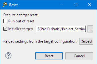

As the title description,how can i cancel the reset prompt window when i press the reset button in the debug state?
Every time when I press the reset,it will jump out the reset prompt window, it is very trouble,I do not want press two times to reset the debug?
the snippet and video of the window I am referring are the attachments,@Felipe García,the previous question can not insert the video or picture,so I ask again here!

To perform a reset is a two stage process, because there are sevaral options what to do in the reset action:
This is by design, and there is currently no way to bypass this dialog.

I think this design is very redundant,It is very Annoying,Does it have any significance?Maybe  this dialog can be confiured in the setting option。

As my colleague Erich said, this dialog is showed because there are multiple options you can do when executing a reset. Unfortunately, there is no setting to avoid the dialog from appearing.
Sorry for the inconvenience this may cause you.

I checked and this behavior is not present on our latest version of CodeWarrior IDE 11.1.

I have installed the cw11.1,it has the problem too,it is same as the cw10.6 ,why?

If you only want to restart the debug session you could click the "Restart" button and the program execution will restart.

I just want reset the debug ,But not  restart the debug ,restart need download the program,it need much more time!
