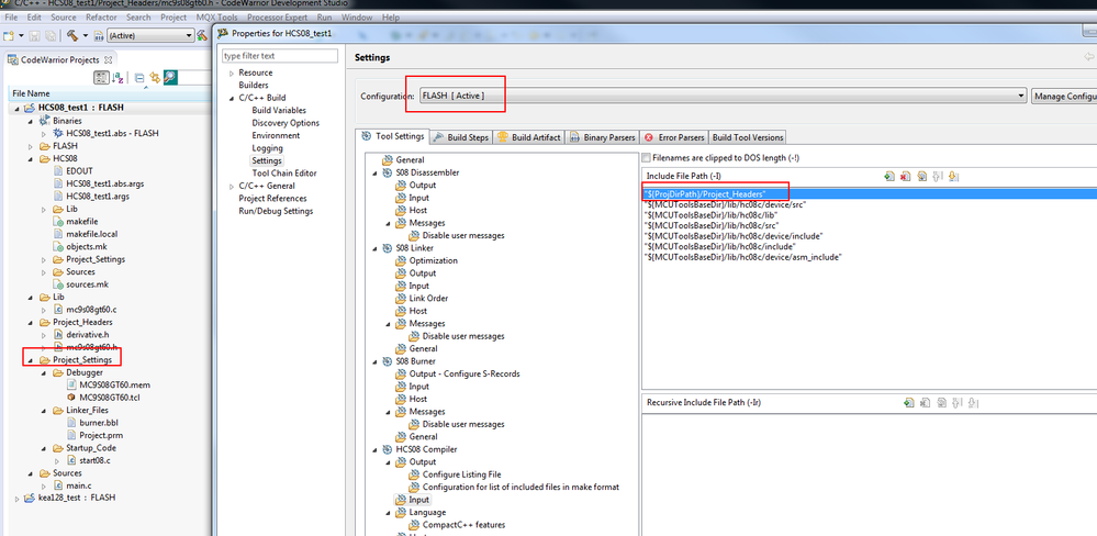

I would like to know the difference between HCS08 configuration and FLASH configuration.Whether the HCS08 configuration is used for debugging ?Whether FLASH configuration can be used for debugging.
For my project,when I tried to build and compiler ,it gives erros for HCS08 configuration for overlapping of segments.Please find the attachment ,but when I compile with FLASH Configuration for the same .prm file ,it does not give erros and produces a .sx file.Whether there any specific settings apart of changing the configuration

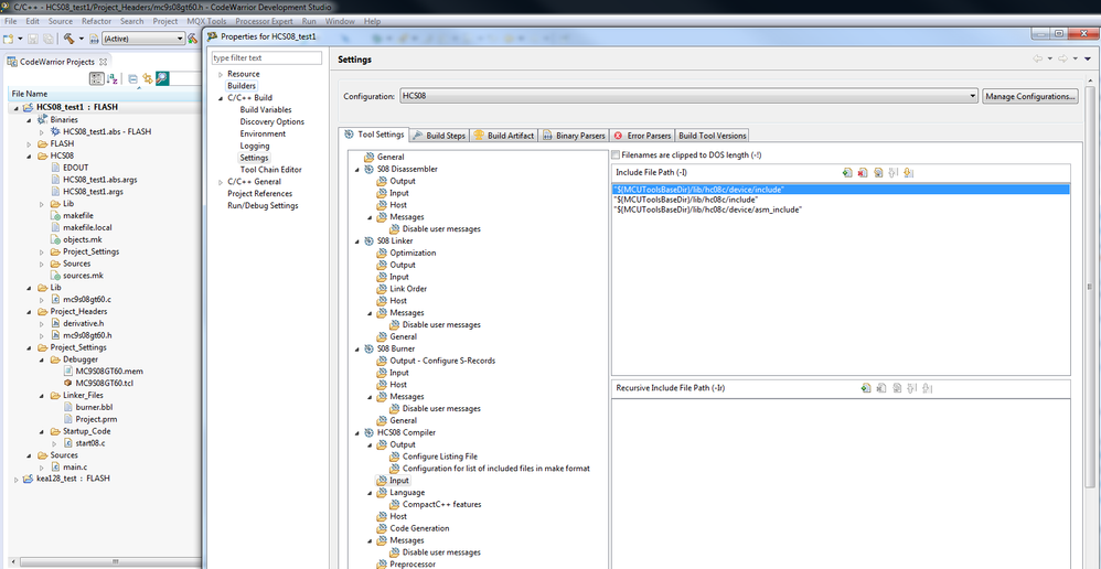

Hello Preetu,
This HCS08 configuration is just a basic configuration ,
it need configured by customer refer to customers' demand .
If only select it ,  then configure nothing,  when build , it will show error .
For example , you can create one simple  project to have a try ,
in the "HCS08 compiler" selection , the HCS08 configuration have not include all the
header files :
So I recommend you use the FLASH configuration .
Hope it helps
Alice

Hello Preetu,
From your screenshot i think maybe you use the CW 10.6 , right ?
If yes , when we create one HCS08 project ,the default configuration is Flash configuration,
there is no HSC08 configuration  :
So the HCS08 configuration is configured by customer ,  from check the contents  between the two
configuration to the difference :
Alice

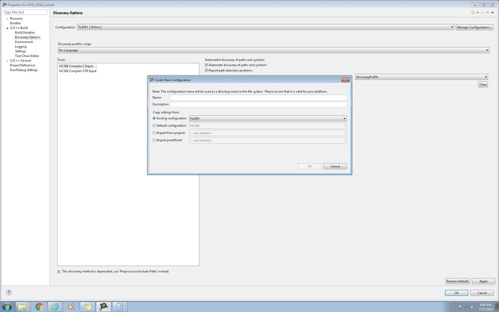

preetuabraham
Hi Alice,
Yes I am using 10.6.4 and the starting configuration is Flash
We can set the HCS08 configuration under the option Manage configuration
