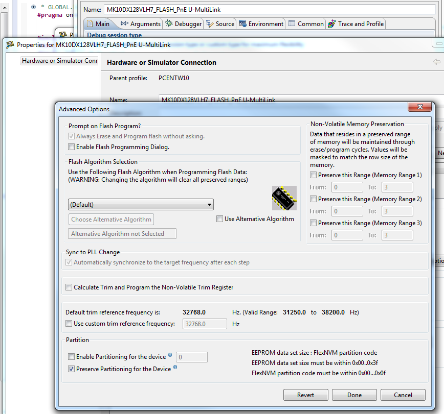

At the moment I'm writing my bachelor thesis about gas analystics. My company told me to take the Kinetis MK10DX128VLH7 MCU
for this project. I haven't found any evaluation board with this specific MCU. So I had the idea to take the FRDM K20D50M board and change
the processor, to simulate my ressources. Well, this idea works and I can program and debug my software! But now, I would like to
save some data in the internal eeprom and flash. So I need to change some settings in the Advanced Programming Options of the CW.
I'm using CW1.6 and there is the following screen:
So now the problem:
All times, when I change only one parameter of these settings for example the "Preserve Memory range" or the checkbox

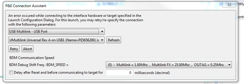

"Preserve Partitioning for the device",I can't debug my program anymore. I get the following error message:
So I tried to reset the settings but that doesn't fix the error message! I have to delete the whole project and
reimport it, to be able to debug the device.

I have found a working way:
Insert the following text to the launch data:
<stringAttributekey="com.pemicro.mcu.debug.connections.pne.arm.PEDEBUG_ALTERNATIVE_ALGORITHM_PATH" value=""/>
<stringAttributekey="com.pemicro.mcu.debug.connections.pne.arm.PEDEBUG_AUTO_SYNC" value="1"/>
<stringAttribute key="com.pemicro.mcu.debug.connections.pne.arm.PEDEBUG_CURRENT_ALGORITHM_INDEX" value="0"/>
<stringAttribute key="com.pemicro.mcu.debug.connections.pne.arm.PEDEBUG_CUSTOM_TRIM" value="0"/>
<stringAttribute key="com.pemicro.mcu.debug.connections.pne.arm.PEDEBUG_DOTRIM" value="0"/>
<stringAttribute key="com.pemicro.mcu.debug.connections.pne.arm.PEDEBUG_DO_PRESERVE_PARTITIONING" value="1"/>
<stringAttribute key="com.pemicro.mcu.debug.connections.pne.arm.PEDEBUG_ENABLE_FLASH_PROGRAMMING_DIALOG" value="0"/>
<stringAttribute key="com.pemicro.mcu.debug.connections.pne.arm.PEDEBUG_ERASE_PROGRAM_WITHOUT_ASKING" value="0"/>
<stringAttribute key="com.pemicro.mcu.debug.connections.pne.arm.PEDEBUG_NGS_TRIM_OVERRIDE_REFERENCE_FREQUENCY" value="3276800"/>
<stringAttribute key="com.pemicro.mcu.debug.connections.pne.arm.PEDEBUG_PARTITION_PARAM" value="13314"/>
<stringAttribute key="com.pemicro.mcu.debug.connections.pne.arm.PEDEBUG_PRESERVE1_ACTIVE" value="1"/>
<stringAttribute key="com.pemicro.mcu.debug.connections.pne.arm.PEDEBUG_PRESERVE1_END" value="268451839"/>
<stringAttribute key="com.pemicro.mcu.debug.connections.pne.arm.PEDEBUG_PRESERVE1_START" value="268435456"/>
<stringAttribute key="com.pemicro.mcu.debug.connections.pne.arm.PEDEBUG_PRESERVE2_ACTIVE" value="1"/>
<stringAttribute key="com.pemicro.mcu.debug.connections.pne.arm.PEDEBUG_PRESERVE2_END" value="335545343"/>
<stringAttribute key="com.pemicro.mcu.debug.connections.pne.arm.PEDEBUG_PRESERVE2_START" value="335544320"/>
<stringAttribute key="com.pemicro.mcu.debug.connections.pne.arm.PEDEBUG_PRESERVE3_ACTIVE" value="0"/>
<stringAttribute key="com.pemicro.mcu.debug.connections.pne.arm.PEDEBUG_PRESERVE3_END" value="3"/>
<stringAttribute key="com.pemicro.mcu.debug.connections.pne.arm.PEDEBUG_PRESERVE3_START" value="0"/>
Now the device will not be partition anymore and you can add the preserve ranges!
