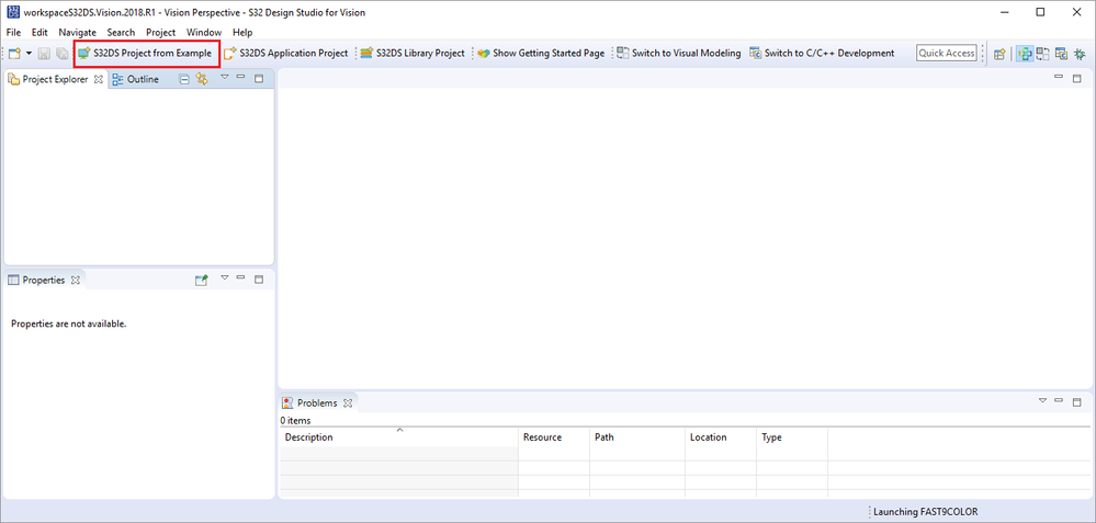

1) Launch S32DS for Vision
2) Select "New S32DS Project from example"

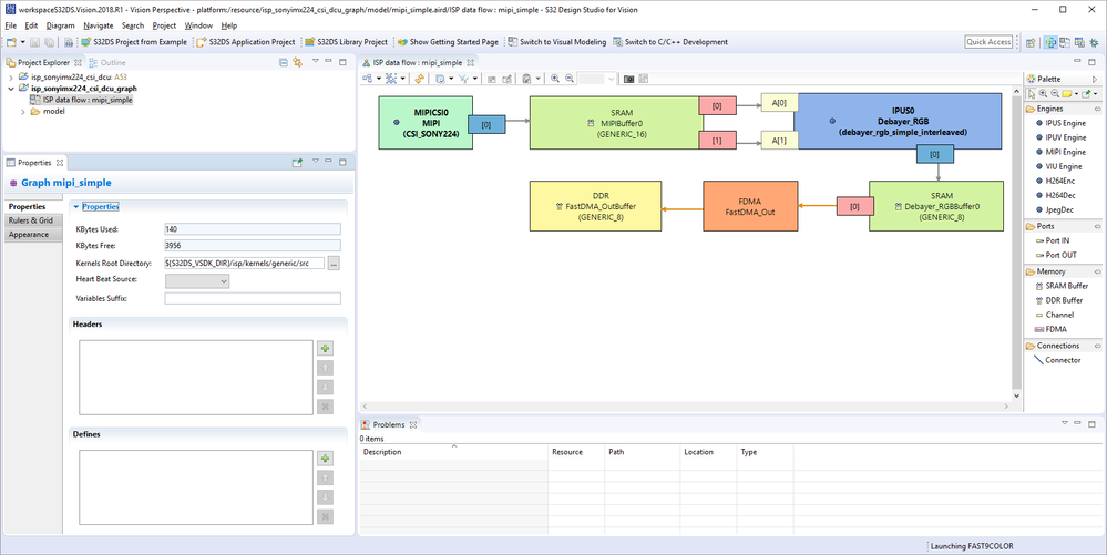

3) Select isp_sonyimx224_csi_dcu project

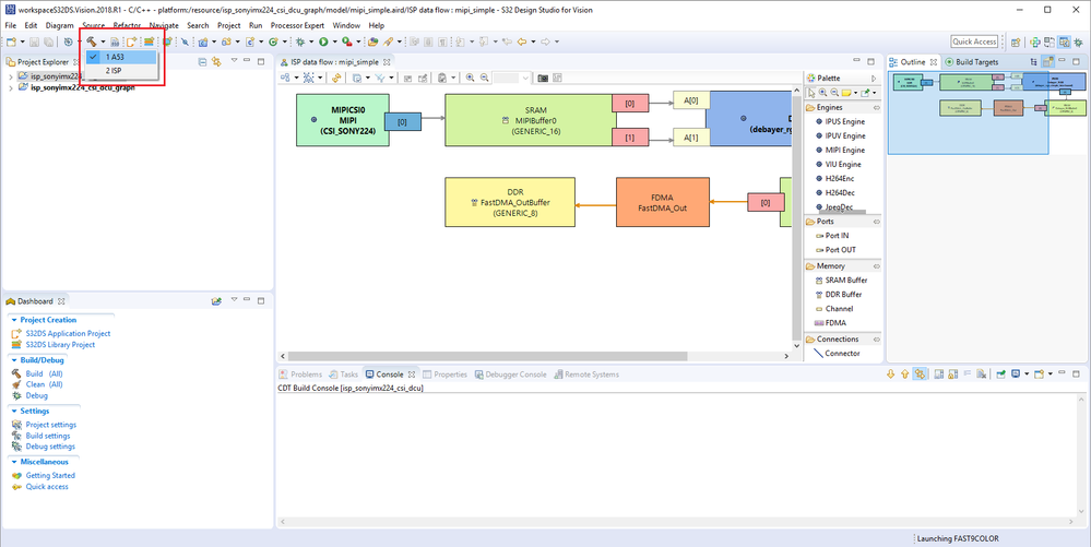

   In this particular project, the ISP graph diagram is included. If you wish to view it, go to the Project Explorer panel and expand 'isp_sonyimx224_csi_dcu_graph'. Then double click on 'ISP data flow : isp_sonyimx224_csi_dcu_graph'. The ISP graph diagram will appear in the editor panel.
4) Change to C/C++ perspective, click on 'Switch to C/C++ Development'
5) Select isp_sonyimx224_csi_dcu: A53 in the Project Explorer panel
6) Build project for A53
7) Start a debug session using method as described in HOWTO Create A53 Linux Project in S32DS for Vision, beginning at step 9.
